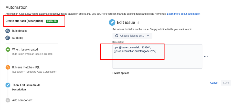

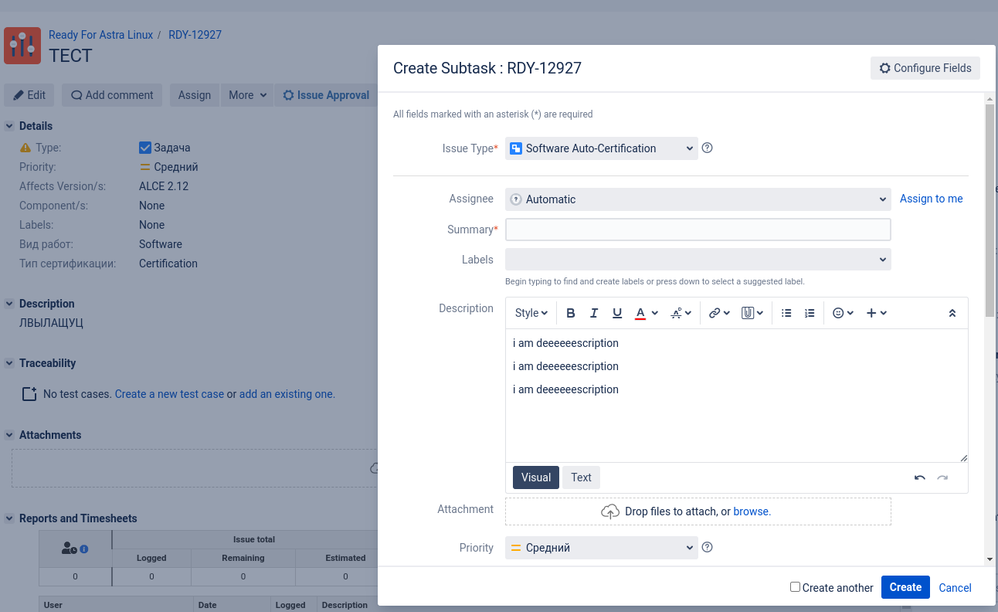

1. Automation .Issue created . Where field "CPU" copying the field to the description

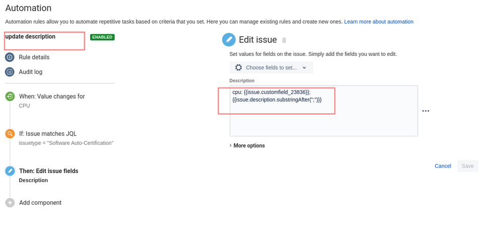

and
2. Automation. Field changed(doesn't work well)
Your help is greatly needed!
I am attaching screenshots
Thanks!

Let's assume your create an issue, with the description in this format where the first line with the CPU ends in a semicolon.
CPU: 4;
here is some description information
Now when your rule is triggered and you perform the edit, you can use the substringAfter() function to substitute in the correct value.
CPU: {{issue.customfield_23836}};
{{issue.description.substringAfter(";")}}You and your team can decide on the format. If you need something more flexible, work with the team to use the replaceAll() function with a regular expression to perform the replacement.

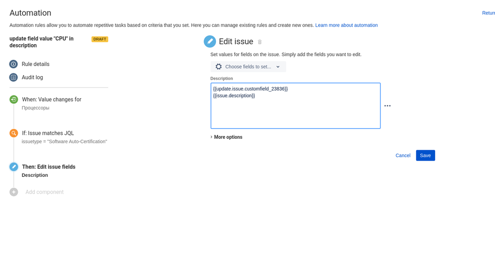

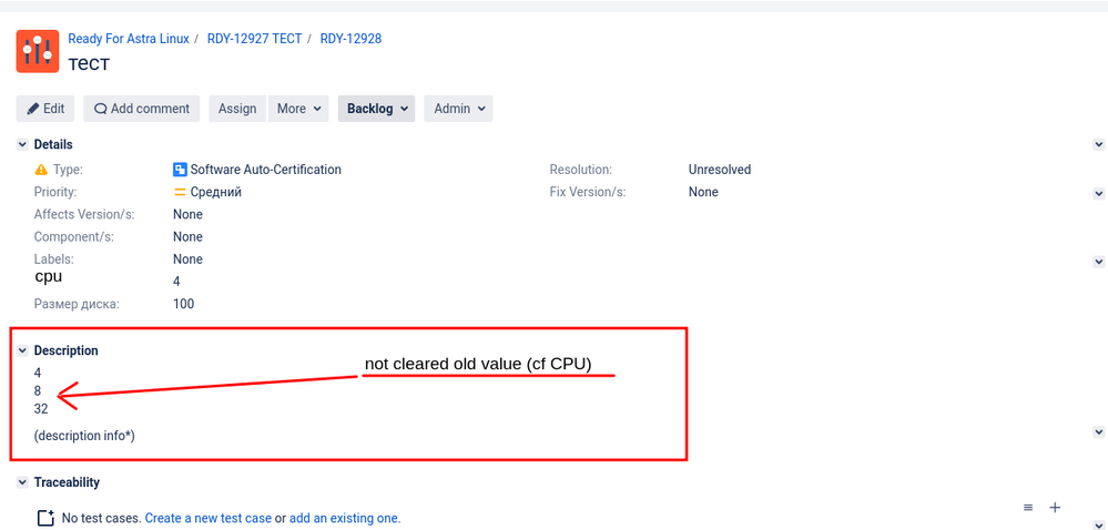

@Bill Sheboy Hi!
I tried adding these smart values and in the description, the cpu value has now begun to be updated - it works well.
But the rest of the “description” (additional information for the task) still clears the value..
Maybe I need to add something?
Thank you

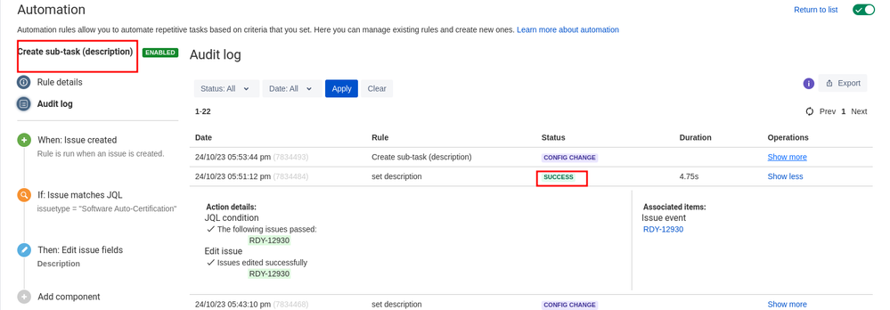

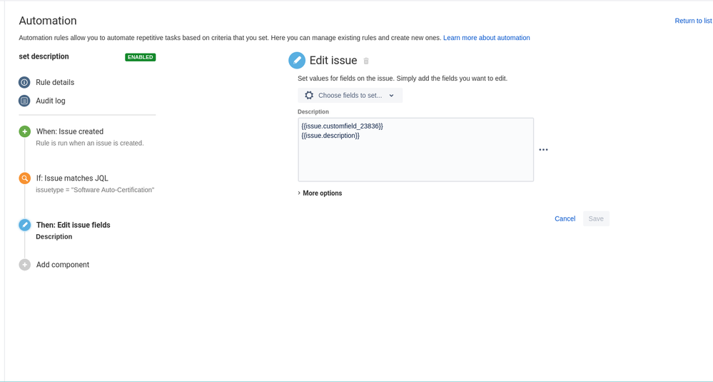

screen create:

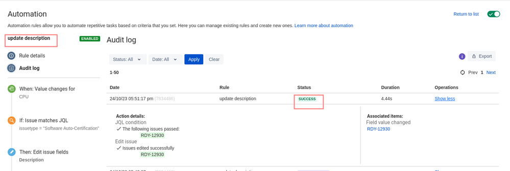

screen 1.automation (create)
screen 1.automation (create)Auditlog
screen 2.automation (update)
screen 2.automation (update)Auditlog

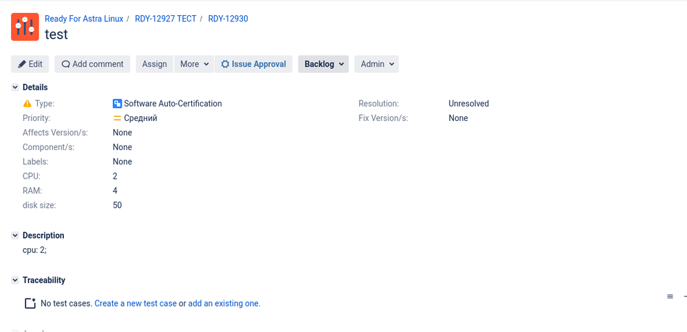

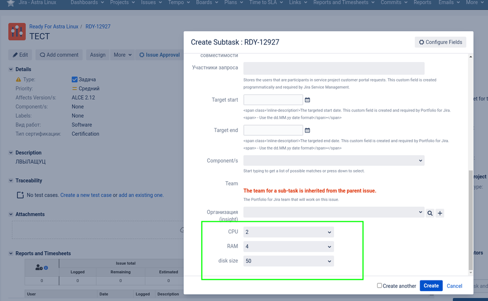

screen before create:

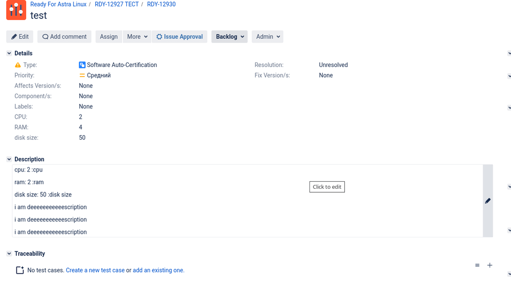

Expected Result :
the value is updated when any of the three fields (cpu, ram, disk size) changes, the main description is NOT overwritten

The structure will always be like this (on the edit/view screen):
cpu: 2 :cpu
ram: 2 :ram
disk size: 50 :disk size
any text after
Great! Now you have a template to create your 16 test cases (assuming the numbers have values) or 128 (assuming the numbers are empty or filled). I recommend pausing to create those before updating your rule.
As long as those "numeric tokens" are not used the "any text after", you could use the replaceAll() function I noted earlier, such as:
cpu: {{issue.yourCpuField}} :cpu
ram: {{issue.yourRamField}} :ram
disk size: {{issue.yourDiskSizeField}} :disk size
{{issue.description.replaceAll("(cpu:.*:cpu)","").replaceAll("(ram:.*:ram)","").replaceAll("(disk size:.*:disk size)","")}}

@Bill Sheboy Hi!
I added your expression to my automation and it works perfect! Thank you very much for your help! :)
