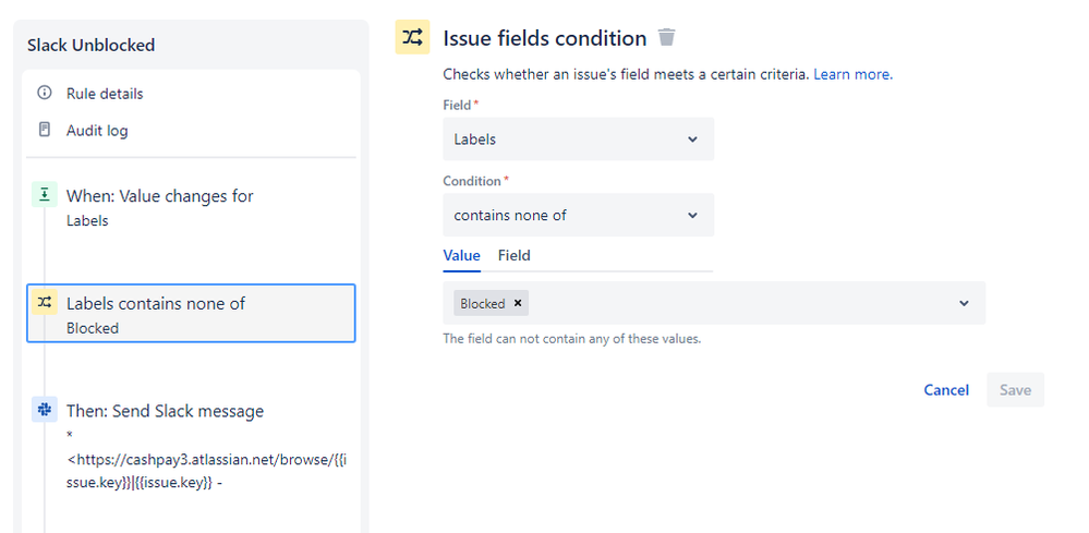

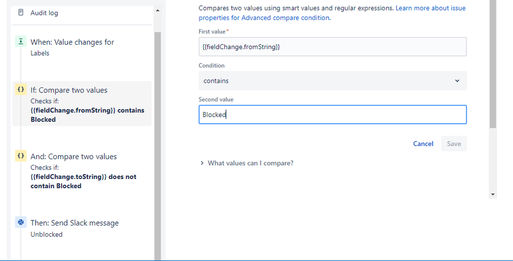

Елена Елена
March 11, 2023
Thanks, Bill
I tried 2 options
Option 1 - It doesn't work
Option 2 - I receive notifications from when I add or remove labels for issues which don't have Blocked label

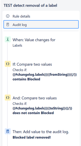

Bill Sheboy
March 11, 2023
For your scenario, fieldChange is not detecting the label change.  Instead please try explicitly checking the field with {{changelog.labels}} such as with this:
Like # people like this
Елена Елена
March 13, 2023
It seems to work

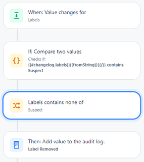

Bernhard Doleschel _Ease Solutions_
February 15, 2024
For me this process did not worked. Changed flow (step 3) works (I´ve tested for "Suspect" label):
