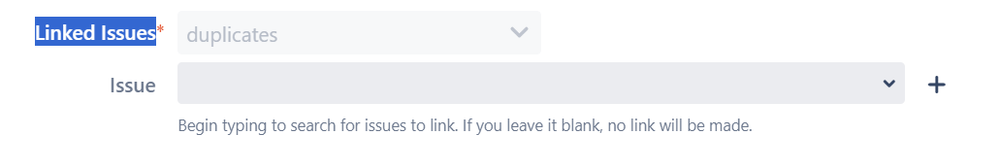

We have transition called duplicate when use clicks it window opens with field Linked Issue then  user choose as duplicate value then we will have another field call Issue (issue searchable field ) for this field how we write validator or scriptrunner script to validate that enter key is bug type then only transition otherwise through error massage (refer attached screenshot for more)

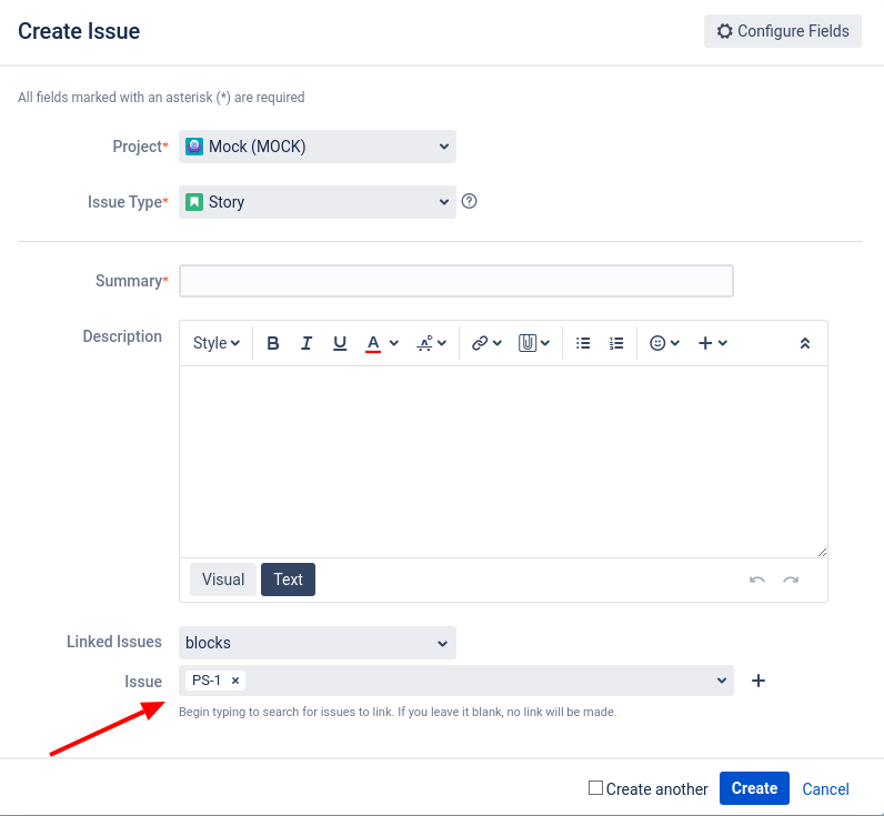

Below is a screenshot of the Behaviour configuration:-
I have added a Server-Side Behaviour for the Linked Issue field in the configuration above.
In the code, I have added a very basic validation on the Linked Issue field that will only allow Story-type issues. If any other issue type is selected, it will return the error message, and the issue will fail to be created.

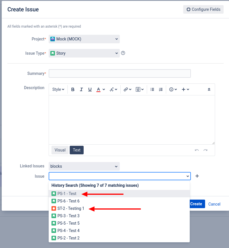

Below are a couple of test screenshots for your reference:-
1. For the test case below, I am going to select 2 issues: one is of the Story type, and the second is of the Bug-type, as shown in the screenshot below:-
2. When the Story type issue is added, as expected, no error message is returned, as shown in the screenshot below:-test2.png
3. However, if the Bug issue type is added, as expected, the error message is displayed as shown in the screenshot below:-

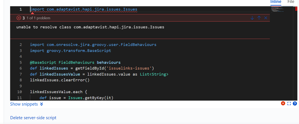

Thank you for the complete solution however facing below package error
any help appreciated

Right, your getting the error message from the import statement because the current ScriptRunner version you are using doesn't support the HAPI feature. Hence, it's not able to invoke the classes from HAPI's API.
Please upgrade your ScriptRunner plugin to the latest release. It will resolve the problem.

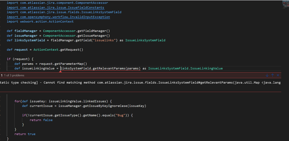

Thank you for the such valuable support. kindly help me to sort error after pasting above code into Simple scripted validator as below
on line
def issueLinkingValue = linksSystemField.getRelevantParams(params) as IssueLinksSystemField.IssueLinkingValue
getting below error: [Static type checking] - Cannot find matching method com.atlassian.jira.issue.fields.IssueLinksSystemField#getRelevantParams(java.util.Map <java.lang.String, [Ljava.lang.String;>). Please check if the declared type is correct and if the method exists.
Also, refer attached screen shot for complete error

Hello @Dayanand ,
You can probably ignore that error message. I have the same behavior on my end. Try saving the configuration and give it a go.
