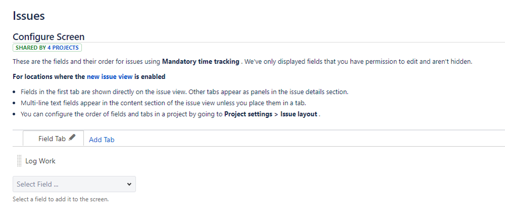

For that you can Edit the transition with that validator and add a screen with the Time Spent/Work log (is the same) field. I even created a new screen to show only that field once.

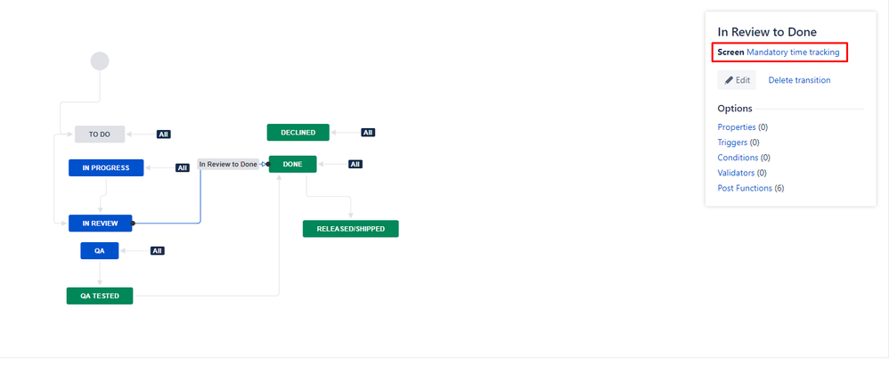

Then I went to my workflow and added this screen to my transitions image_2021-03-04_111436.png

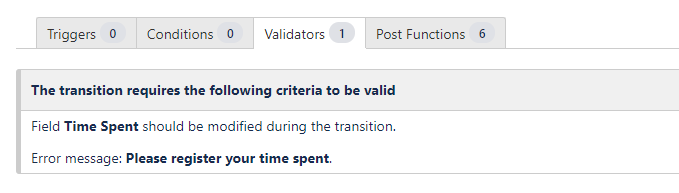

Also I added a validator on the transition that needs the Time Spent to be modified during the transition
That's all !!!

The check from a validator triggers during transitions, so if you want to force a value in a custom field to be written (i.e. Time Spent), you can add a screen in that same transition, only showing those fields that you want to be filled, and the check will be effective.
@Orestis Michos is given a marvelous, step by step, with screenshots, here :)
