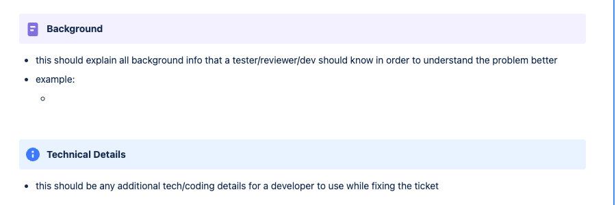

Hello!
I'm using Adaptivist's Scriptrunner for Jira Cloud to create a behaviour that will set the Description field to a default template on the create screen when creating specific tickets. The portion that I'm struggling with is how to write info panels into the description template so that they show like this on the create screen:

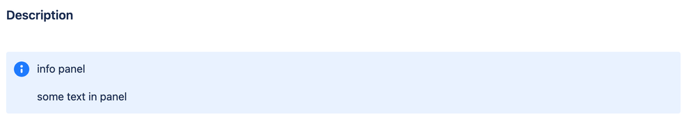

Hi @rneill19 ,
this format is called Atlassian Document Format and you can play with document Builder
Just add a panel and it will generate a payload for you
https://developer.atlassian.com/cloud/jira/platform/apis/document/playground/

Hey Max,
Thank you so much - that tool is so helpful and exactly what I needed!
