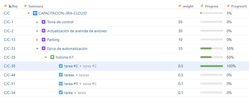

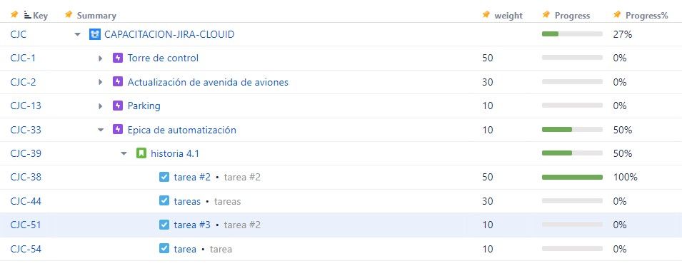

See the following calculation that is wrongly calculated for the grouped line (image #1 - Key CJC) showing 27%, against the workaround calculation (image #2 - Key CJC) showing 5%.
The problem we see is that when you group issues, the total progress calculation under an "issue progress based on field and weighted" the weights for the grouped line item considers all lines were there are weights included.
Has anybody solved this problem with.  The workaround was to weight with round numbers the epics and to weight with decimals the sub-issues. (See image #2).
Image #2 - Work around

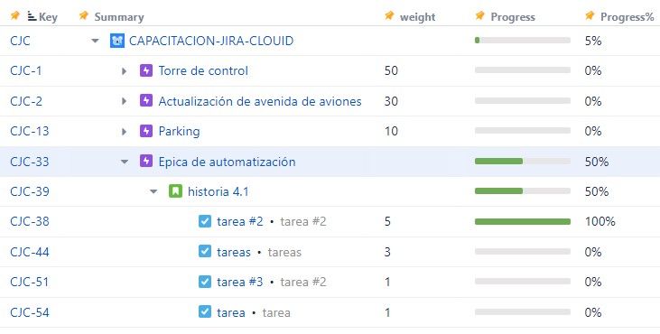

In your case I found it very clever to use decimal to avoid double counting by weight. And on your second picture the total progress seems to be more correct than on the first one. I guess you are right about  that it behave as if it were Story point custom field. And on the first picture-  we see that total weight for sub-issues is much higher than total weight of Epic that contains those story with sub-issues. ( I guess the problem is also that sub-issue can’t have weight more than epic by itself , because weight of epic = sum of weights of all issues entering this epic . In your case I see that epic has 10, but total weight of sub issues is 100.  So projects total progress is calculated  as of weight =200… try to change values of weight of sub issues as ( 5, 3, 1, 1 ) instead of 50, 30,10,10.

Yup, works fine now.  Using a numeric field to weight progress on a "total progress calculation" when grouping Top Issues has to be used to add up 100 including all issues (parents and childs).  Doing this, then it seems to calculate as expected. But, small but, key CJC-33 and key CJC-39 has to be empty since sub-issues have been weighted, otherwise, if populated with weight, they will be added twice or tripled.
