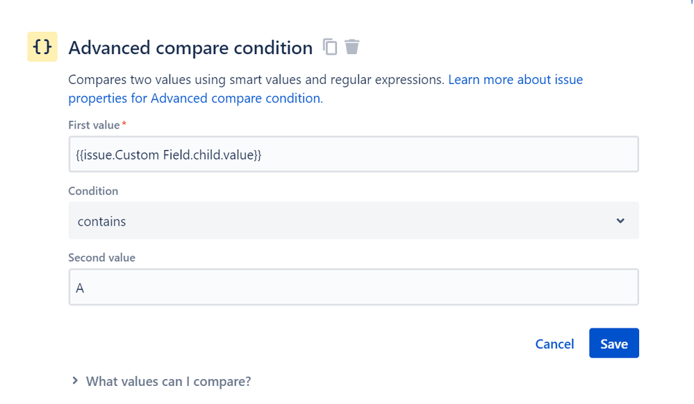

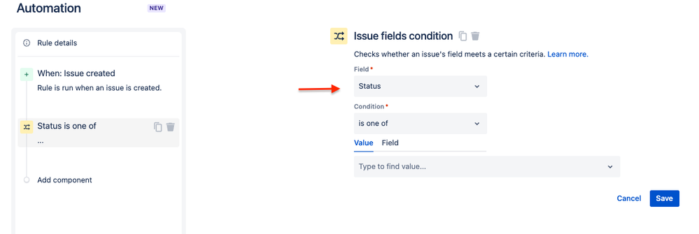

The custom field should show up then. What actually triggers the the automation rule? When the issue is created? When the field is updated?
And you are trying to add a condition and the field doesn't show up? Have you tried doing an advanced condition? Use the smart value for the field: {{issue.Custom Field.value}} of {{issue.Custom Field.child.value}} where Custom Field is the EXACT name of your custom field.
Deleted user May 24, 2023
1. When the Issue is created. This triggers the automation rule
2. Exactly, I am trying to add a condition and the field doesn't show up in the dropdown.
3. I tried reading how an advanced condition should be used but the I am finding it difficult to understand instructions in the article. Also I am finding it difficult to understand how to use a smart value.Screenshot 2023-05-24 at 17.48.53.png
John Funk
May 24, 2023
Choose the Advanced Compare Condition instead of the Issue Fields Condition.

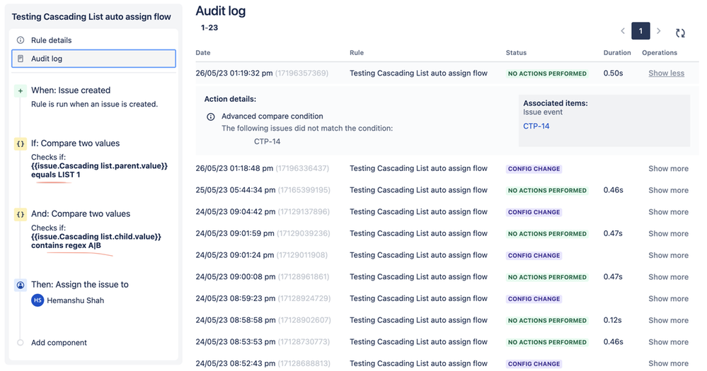

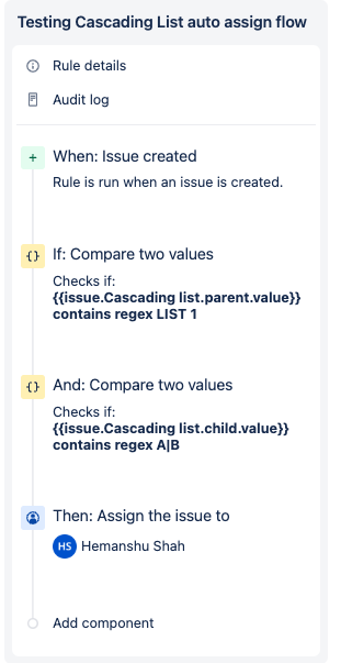

Hi @John Funk ,
I tried to extend the automation flow by adding another Advance Compare condition in series to create a AND condition between the Parent value and the Child value. However, the Automation flow is not working.
I checked the Audit logs. There is no error. However, it shows the Automation ran successfully and No action was performed.Screenshot 2023-05-24 at 21.04.59.png
John Funk
May 24, 2023
Can you share the audit log? Because that will tell us if the Conditions actually passed or not.

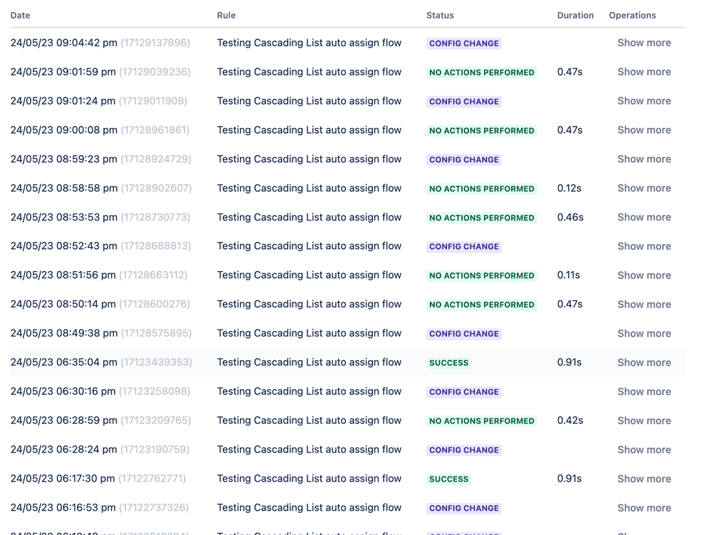

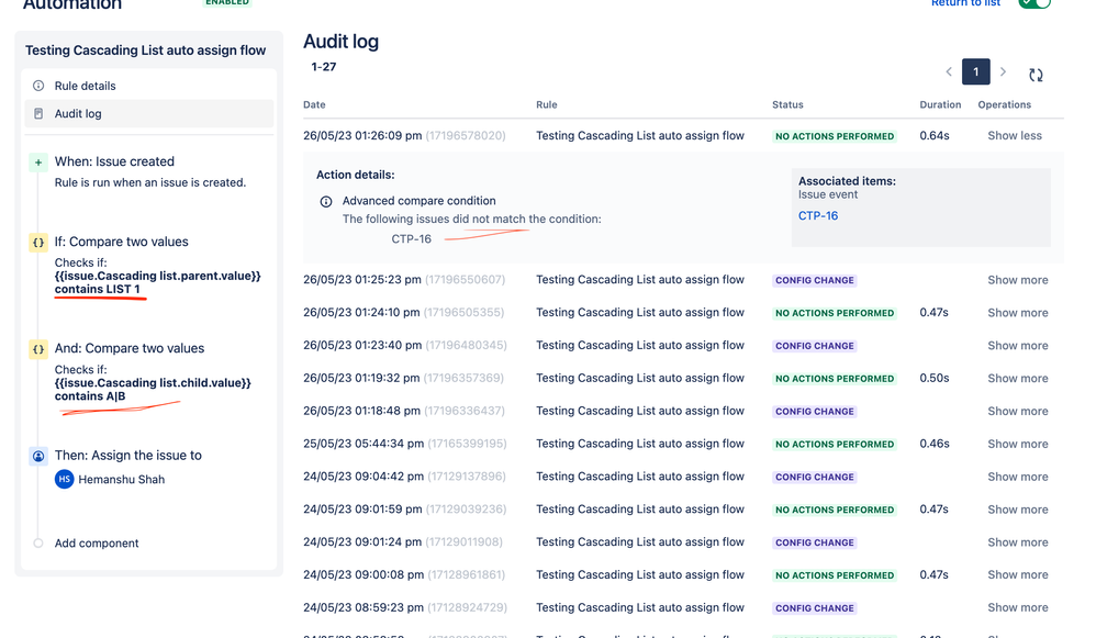

Deleted user May 25, 2023
John Funk
May 25, 2023

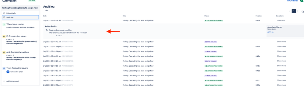

Can you do the Show more to show the details of the instance where you ran it and it did not work for you? I see no actions performed on several of the latest ones which tells me one or more of the conditions were not met.

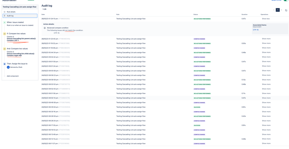

John Funk
May 25, 2023

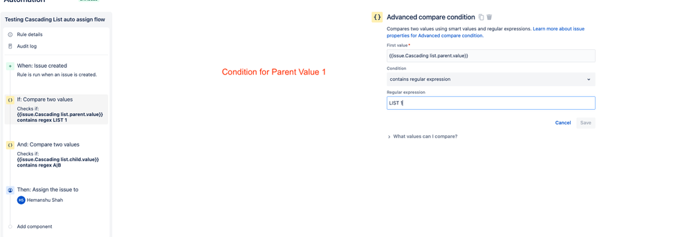

Okay, that's your problem then - it is not passing the first condition. You either have a syntax problem or there are no values that match.
Can you share the details of the advanced condition?

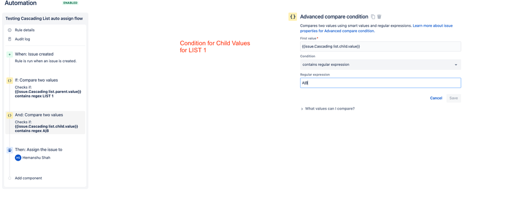

Deleted user May 26, 2023

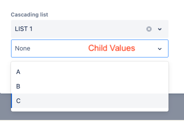

Sure. Here are the screenshots for Parent values and Child values (For Parent Value = LIST 1)
Further, you can also find the screenshots for the Advance compare condition for Parent and child valueScreenshot 2023-05-26 at 10.56.26.pngScreenshot 2023-05-26 at 10.56.48.pngScreenshot 2023-05-26 at 10.57.34.pngScreenshot 2023-05-26 at 10.57.46.png

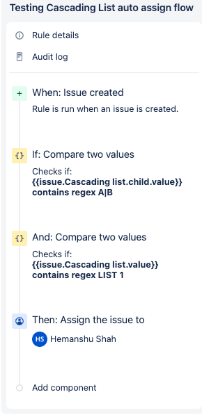

Hi John,
Thanks. I tried some combinations from your suggestion. This worked for me.
Rearranging Child above parent and using "contains regular expression" in both parent and child conditions.
A big thanks!!
John Funk
May 26, 2023
Great! Glad it is working. But I think the key is that you took out the word parent from the one. I would still move that one above the child one - it should still work that way.
