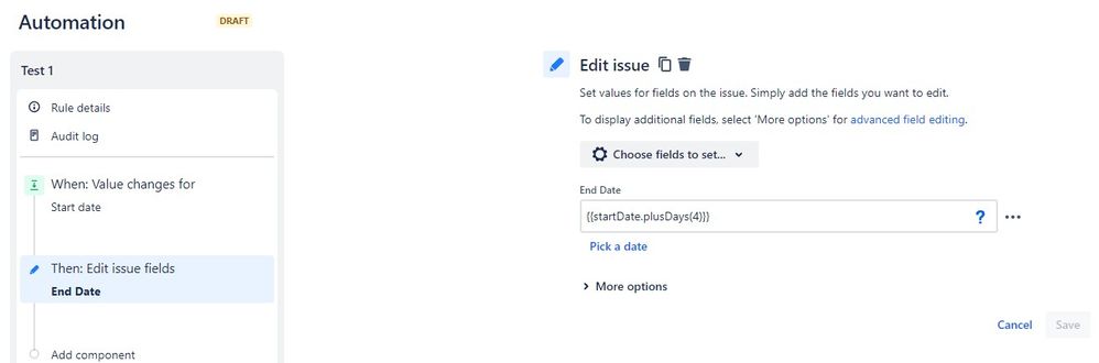

can someone explain why the following smart values don't work/ don't return a result?
I need the following calculation "End Date" = "Start Date + 4 weeks". My problem is, that the start date which the Team sets isn't always the same day - That's why I want to avoid replacing "issue.startDate" with "now" as smart value
According to the Log, the rule was successfull, but when I check the "End Date" field in the ticket, the field is empty.
However if I replace "now" with "issue.startDate" the automation rule actually works and returns the correct date. Using only "start.Date" doesn't work either.
Thanks for your feedback!

Hi @Oliver Trang
Try to write
{{issue.Start Date.plusDays(4)}}
Oliver Trang
April 11, 2023
Hi @Alex Koxaras -Relational-
thanks for your response. That was actually the only option, which I haven't tested out and it worked!
