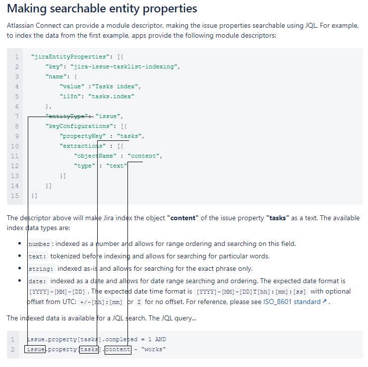

I think this could help

Unfortunately, this is the very article I've mentioned in the question, it describes how to index for searching property with a JSON value, not text.
In the example, they got something like
  content: "Hello, World!"
as the "tasks" property value.
