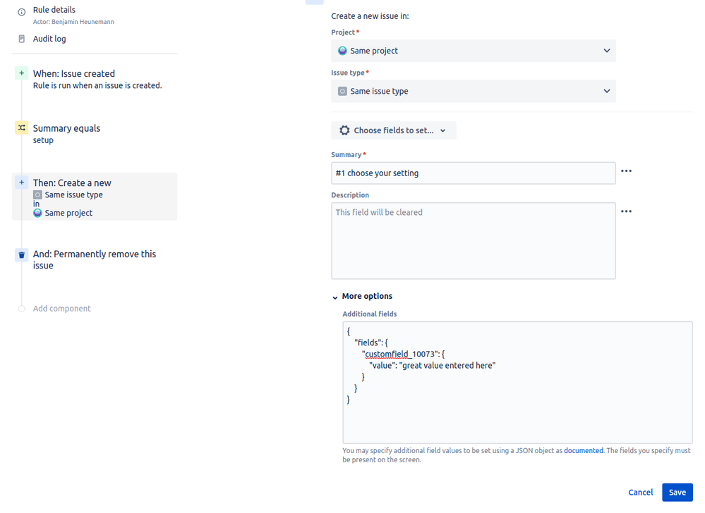

Hey, I am desperately trying to have custom fields created on a global aspect (issues > fields > custom fields) show up and be usable in business projects, especially for automation.
My idea:
  • I created a simple text field with a few options (as mentioned under issues > fields > custom fields)
  • if in a business project an issue under certain conditions is created, a new issue with pre-filled information, among them the custom field, will be created
  • neither does the custom field show up in the project's issue types settings nor does (global) automation recognise the field:
    "Unknown fields set during create, they may be unavailable for the project/type. Check your custom field configuration. Fields ignored -" (followed by the field name)
  • also the field does not show up in the new project's task configuration screen (which is most likely to be related to the error)
I have no idea what to do and feel like I've looked everywhere. Does anyone have a hint?

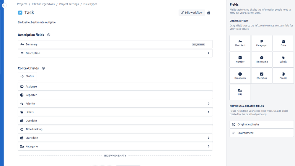

So yes, I am working in a cm project. And while writing this answer I kept on trying different things and narrowed it down to the project's screen scheme under /plugins/servlet/project-config/<projectkey>/screens because this is what is essential obviously.
When the new cm project is created also new project related screens are created. I would rather have a setting somewhere to say "use this screen/screen scheme for new projects instead creating a new one every time". Is there something like this? Because I have created one I would like to use as standard which contains the necessary fields which are not taken into the automatically created screen when the project is created. Alternatively how can I manage to have the custom field being used for new screens?
The following picture shows the place where I changed the screen scheme by hand to a working one that includes the fields I need.

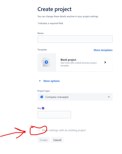

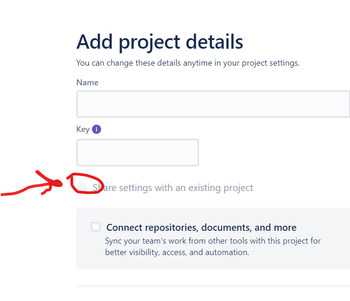

If you choose Jira Software, just keep walking through the prompts - including Use this template. Eventually, you will select a Company managed project. After that you should see this:
For Jira Work Management, you can select the Blank Template. But on the next screen, be sure to click on More Options link.
Then change project type to Company Managed.
Then you will see the option like above:

This is indeed interesting. And I realise now why I can't do it, it's not possible in the free plan and since we are only trying the software now to check if it's working for us the option is greyed out :) Alright, but I have come a bit further.

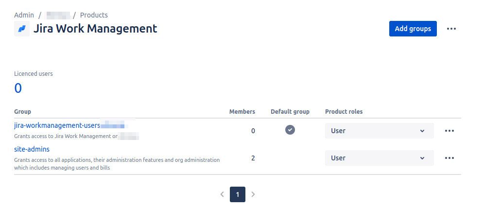

Would it be of any use to have a group of users who get some kind of Jira Work Management admin role and then be able to create company-managed projects? Currently in free plan I can not create new roles so maybe this is a way in paid plan?
John Funk
October 6, 2022
No, only full blown Jira Admins will be able to create the Company-managed projects in Jira Work Management and Jira Software. There is no separate permission that will allow others to create those.
Under the Free plan, EVERYONE is a Jira Administrator. But not so with the paid plan.
