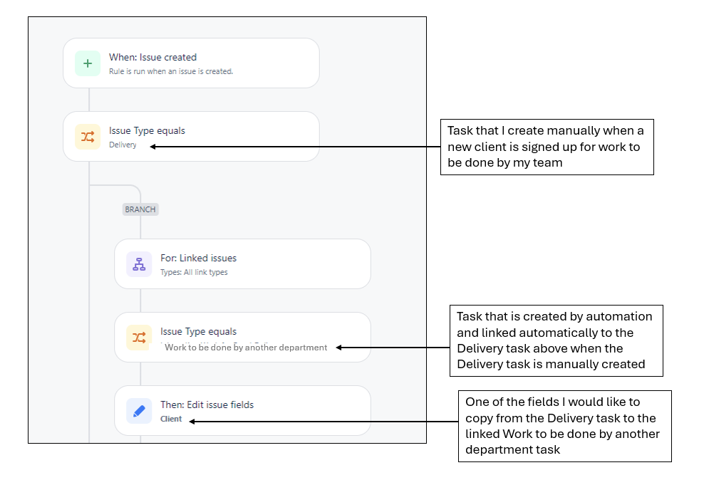

Hi everyone. I'm having trouble with linked issue automation and am hoping you can tell me where I'm going wrong.
The below shows my use case and how I've tried to set up an automation to copy some fields from a manually created issue that triggers the creation of a linked issue into that newly created linked issue. But when I ran this automation no fields were copied and the audit log said no action was taken because no related issues could be found.
I'm not sure if it matters but I am working in a team-managed project. And yes, the linked task is being created within that same team-managed project.
Thanks in advance for any feedback or suggestions!

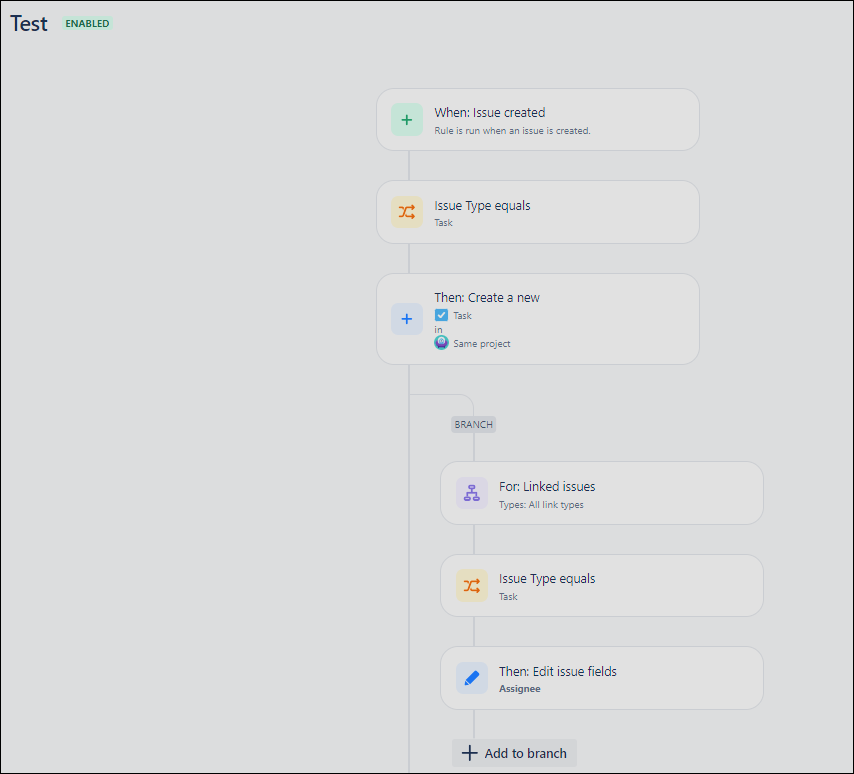

Hi @Susan Merola
Per your description below, I don't see the action to create the new linked issue on the rule. Is that missing? - that could be why you see the message in the audit logs.
I've done a quick test using a team-managed project and an automation rule that represents what I think is an equivalent use case. I just added the step to create the new linked issue.
Feel free to review and take it as a baseline to improve what you have further.

Hi @Pablo V_ . Thanks for your reply.
Yes, the automation to create the linked task happens in a separate automation, so I'm going to try Trudy's suggestion of adding a delay and if that doesn't help then I'll try combining the 2 automations so that the linked issue gets created and the fields get copied within the same automation as you've suggested above.

Yes, I have a separate automation that runs when I first create the Delivery task for my team. In that automation, several sub-tasks are created and the linked issue is also created.  So it could very well be the problem is that the automation to populate the linked issue needs to run on a delay. I'll try that and see how it goes.
This is what the automation said. 11373 refers to the Delivery task.
