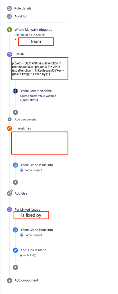

I am using JIRA Server and I'm having trouble using an existing smart value inside a for loop.
Example:
  • CORE-1 'is fixed by' FIX-1, FIX-2, and FIX-3
  • SEC-1 'is related to' FIX-1, FIX-2, and FIX-3
I have a jira automation (action) that does the following:
  1. Clones CORE-1 into CORE-1a
  2. Updates some metadata on CORE-1
  3. For each 'is fixed by by' FIX:
    1. clone FIX-1 into FIX-1a
      1. link FIX-1 as blocked by FIX-1a
    2. clone FIX-2 into FIX-2a
      1. link FIX-2 as blocked by FIX-2a
    3. clone FIX-3 into FIX-3a
      1. link FIX-3 as blocked by FIX-3a
What I'm not having trouble doing is setting SEC-1 'is related to' FIX-1a, FIX-2a, and FIX-3a.
In the jira automation, I set a smart variable successfully at the start such that {{secticket}} is set to 'SEC-1' by using a For JQL.
However, in the for loop 'For each 'is fixed by by' FIX:', I try to set FIX-1a, FIX-2A, and FIX-3a as 'related to' {{secticket}}, but {{secticket}} is EMPTY.
Is this a limitation, or am I doing something incorrectly? Is there a better way to accomplish this?

Automation branches which could be on more-than-one-thing run in parallel and asynchronously, and there is no guarantee of when the branch will complete...up until the last step of the entire rule.
https://confluence.atlassian.com/automation/branch-automation-rules-to-perform-actions-on-related-issues-993924648.html
For a rule which creates variables inside the branch, this means that each one is created independently, and thrown away as each pass through the branch / loop completes.
What does your created variable contain / represent?  Knowing that may help identify an alternative rule structure to find the value.

here's some redaction but the flow is the same! On that last step of link issue to {{secticket}}, it errors. I did confirm that {{secticket}} has the correct value after the variable is created at the top.

I would suggest to create the variable with empty value before the "For Jql"
