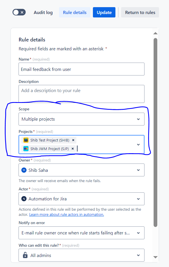

Hi @Marcelo Canaparro , Once you have created a company managed project and configured it and make it ready to be used as a template for next phase of project. There are two separate things one is scheme of the project and another one is the automation rule.
1. For all the schemes to be copied to another project, at the time of project creation you will see an option 'Share settings with an existing project', tik this box and search for the existing project in the search box and select, it will copy all the schema of the project to your new project
2. Automation, for this you can change the scope of the automation to as many projects as you want and the rule will be applicable for that projects too. As shown in the screen shot.
I hope this will be helpful for you, please don't hesitate if you have any query. Thanks

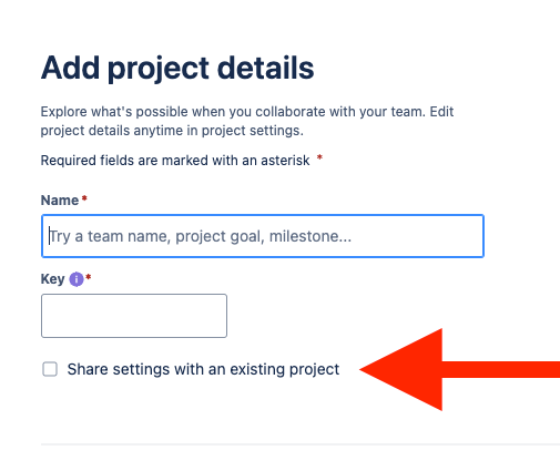

July 30, 2024
Hello @Marcelo Canaparro
When a new project is being created when you get to the final screen where you would enter the project name, then you can choose the Share Settings option.
After selecting that, you can select the existing project that has the configuration you want to use for the new project. Note that this means the new project will use the same schemes as the original project. If you make changes in those schemes it will affect both projects.
This does not copy the agile board associated with the project, nor does it copy Automation Rules, nor does it copy other project-specific information like Components, Versions, or individual issues.
