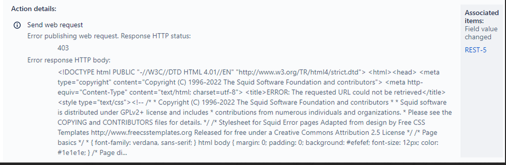

Hi @Trudy P Claspill ,
I used JIRA automation feature to send data to database using a POST REST API with header values, used 'Send web request' feature which is available under Global Automation. But I received the below error code and message.
Furthermore, I tested above REST API using POSTMAN and used Webhook site to verify whether the required data is received at the Webhook as we expected. In both cases it is success.
When you use the Send Web Request action in an Automation Rule, the action is being executed from the Jira Cloud system out on the internet rather than from your workstation. Is the URL you used internet accessible?
403 is the "Forbidden" error.
https://developer.mozilla.org/en-US/docs/Web/HTTP/Status/403
Have you included in your Send Web Request action the necessary information for the Jira Cloud system on the internet to comply with authentication requirements to access your PC?

I am assuming that the system on which you database resides and the database itself require username and password to authenticate, even if exposed to the internet.
As such your request is going to have to either provide sufficient information to get past that authentication, or you have to disable the requirement for authentication, potentially exposing your system/database to intrusion from the internet.
