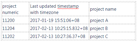

1.For example,the attachment is SQL's result
2.Those project's Permissions all set to Standard_Permission_Scheme,I want to use api or CLI plugins to bulk update project(Example:project A,B,C) permission to Readonly_Permission_Scheme
