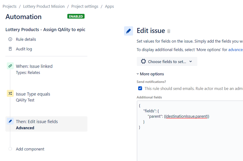

Hello!
I have the following automation in nextgen project:
* When issue is linked, assign the new linked issue to the source issue parent (epic).
However, I keep getting "invalid JSON" error.
Any idea?

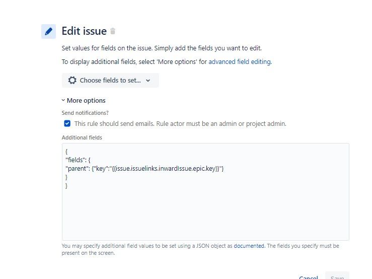

Hi @Matan Grady

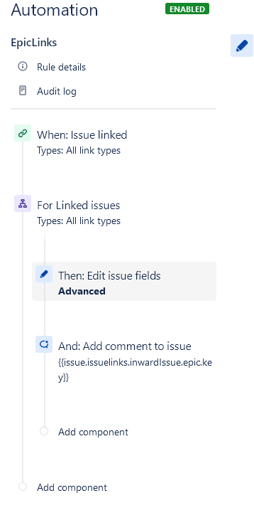

looking at your requirement I was able to reproduce an automation rule which worked fine in my demo next-gen project.
Setup: I have an Epic (ACC-4) as well as a story (ACC-2) linked to the Epic.
Now I have an additional story (ACC-3) that I link to previously created Story ACC-2.
=> The Epic link (to ACC-4) is added to ACC-3
In case I got you right here is the automation rule so you can double check:
The interesting part might be "Edit issues fields" where the following JSON made it work:
"fields": {
"parent": {"key":"{{issue.issuelinks.inwardIssue.epic.key}}"}
"Add comment to issue" however was just for testing purposes - I would not put that into production.
In case you'd like to check and let us know if this is what you were looking for I'd appreciate that.

Matan Grady
April 18, 2021
Hello @Daniel Ebers .
Still can't get it to work!
Note that I can't do the change on the branch as the item I am editing is on the main branch.

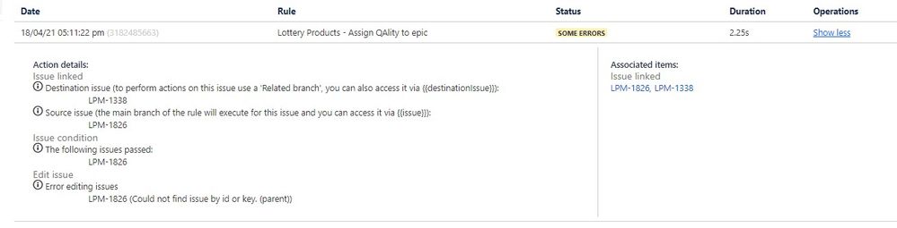

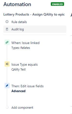

The setup I did it attached, so is the error I get ("Could not find issue by id or key. (parent)".65469879.jpg13246579.jpg132132132.jpg
Daniel Ebers
April 19, 2021
I am unsure if it works the way you setup the rule - probably this won't be the case.
Unfortunately, I cannot tell you anything beyond this but to confirm the rule I suggested worked in my setup.
Probably you will find other users contributing to fixing the rule you presented.

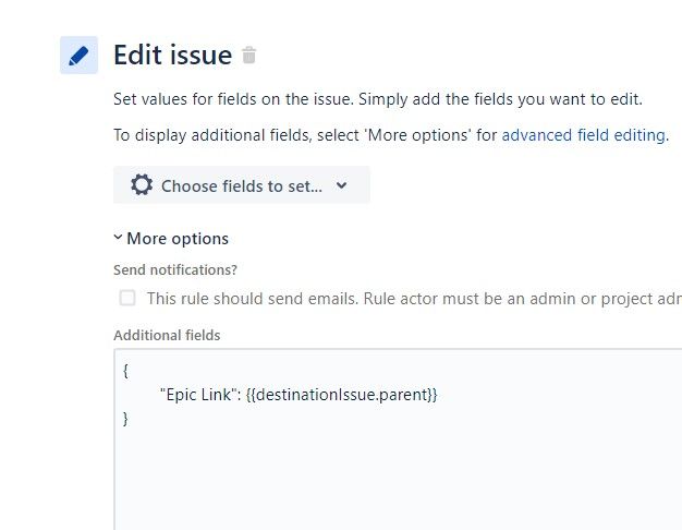

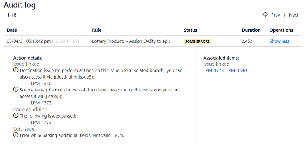

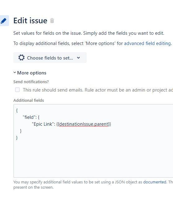

I need to update the field from advanced field editing.
This is how my JSON looks like.
Still I get an error of invalid JSON.
Any ideas?

Bill Sheboy
April 6, 2021
When you edit/update an issue, that issue needs to be the focus in the rule.  For example, it needs to be the trigger issue or an issue within a branch's selection.
Although you may be able to see the key of a parent with the syntax you are showing, the rule isn't updating the parent: it is not "in scope".
Just to be clear, are you trying to update:
  1. the parent of the issue that triggered the rule, or
  2. the parent of the issue that was linked to the issue that triggered the rule?
If you want #1, as simple branch on parent should work.  If you want #2, you would need to use a branch on JQL for the key of that linked issue's parent.  They you may perform the edit within the branch.
Matan Grady
April 6, 2021
Hi @Bill Sheboy ,
This is not my problme. My problem is how to update the issue (I am already on the right branch for it), but assign a parent to it.
For example, update issue X-123 to be a child of issue X-5.
