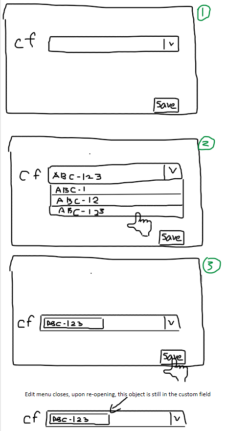

Hi, I was wondering if someone could help explain how I would be able to update a custom field using the jira python api.
Normally, this custom field is added manually by typing the item key to be attached into the search bar, then selecting the item that appears from the drop-down menu. Once selected, the item appears as a box under the custom field. After saving, the same linked item can be viewed after closing and re-opening the edit menu.
I attempted to update the custom field using
new_issue.update(fields = {"[custom field id]": { "key": feature_issue.key }})
but the field doesn't seem to link the given key to an actual item as the selection disappears upon re-opening the edit menu
Hopefully my drawings below can explain my ask. Any guidance is appreciated, thanks!
