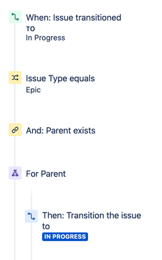

Your plans are structured through an issue hierarchy. That means that you only have to change the status of your initiative to In Progress as soon as its first child issue (which will usually be an Epic) transitions to In Progress.
That is pretty simple to automate like this:
In a similar fashion, you can automate the status transitions of your Epics as soon as a child issue transitions to In Progress.
Hope this helps!

Thanks @Walter Buggenhout . Unfortunately, the 'For Parent' branching is not working since I am working with Roadmap Item and Initiative of the Advance Roadmap. Looks like JIRA doesn't recognize the 'Initiative' as Parent for the 'Roadmap Item' and so when I use 'For Parent' it simply doesn't do anything.

I can imagine that. Just look at the hierarchy configuration of your advanced roadmap setup to see how items in your plan are linked to the higher levels of your hierarchy. Children can only update their own parent in the way I described. And then again, those can update their parent. And so on.
