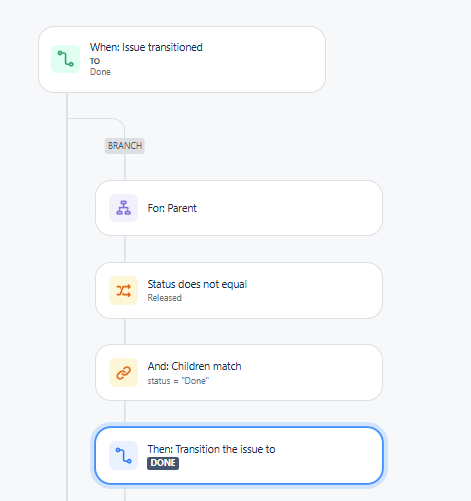

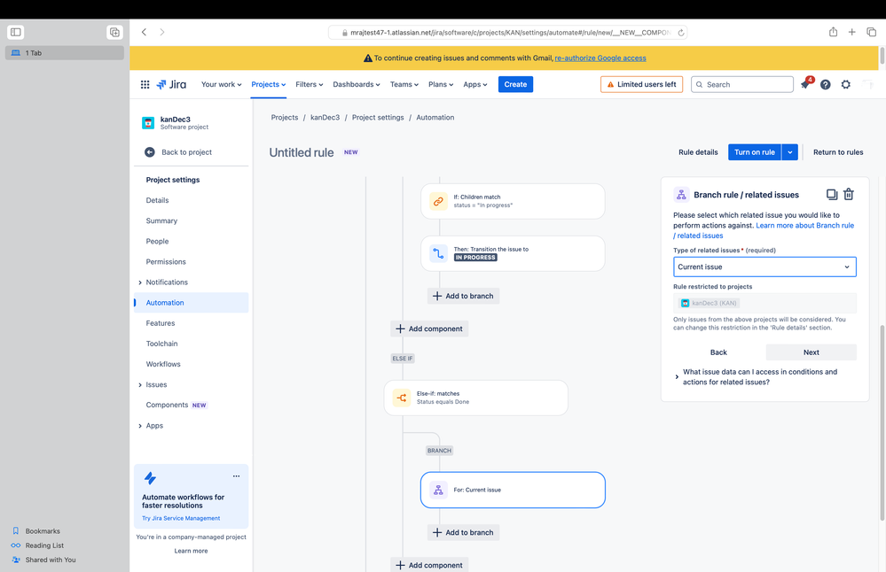

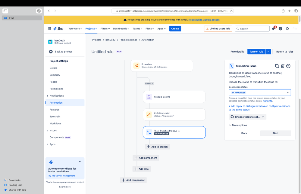

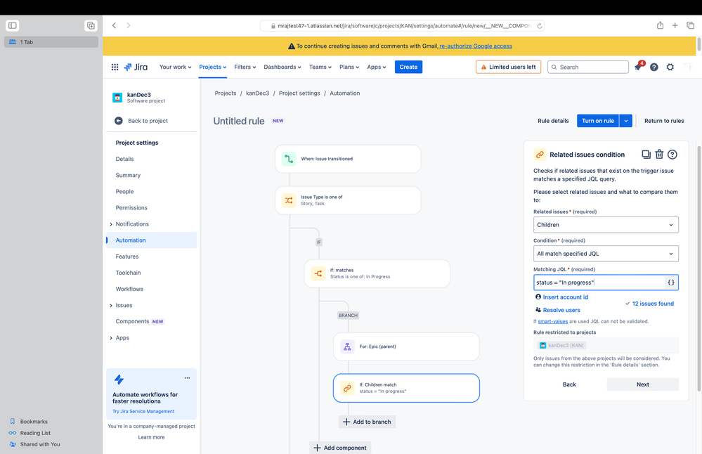

I want to do an if statement in my automation to set the Epic status based on the status of all the children, or some of the children
I have it working when it's only doing 1 check. When all children statuses = Done then set the Epic status = Release. - This works fine
If that's not true, then I want it to check all children statuses = Shelved, if true set Epic status = Shelved
  • Else if all children statuses = On Hold, set Epic status = Hold
  • Else if a single child status = Design, set Epic status = Development in Progress
  • Else if single child status = Requirements, set Epic status = Requirements in Progress
Do I use the same automation rule or do I need to create different rules?
Mohanraj Thangamuthu
January 28, 2025
Hello, Good day. You could use If/else condition in the rule as shown below.
Screenshot 2025-01-29 at 10.44.17 AM.pngScreenshot 2025-01-29 at 10.44.32 AM.pngScreenshot 2025-01-29 at 10.45.01 AM.pngScreenshot 2025-01-29 at 10.45.32 AM.png
