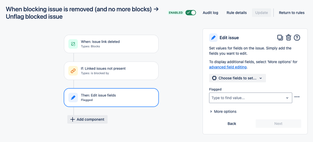

I want my automation to:
  1. flag an issue when it's blocked by another issue
  2. unflag when it's not blocked anymore
To cover these cases, I've created some automations that work for some cases:
  • When blocking issue is added → Flag blocked issue
  • When blocking issue is resolved → Unflag blocked issue
However the issue doesn't get unflagged when all blocking issue are unlinked. I tried this automation but it doesn't work for some reason.
Questions:
  • What's wrong with the rule above?
  • Is there an easier way to achieve my goal? (vs creating multiple rules to cover all cases)

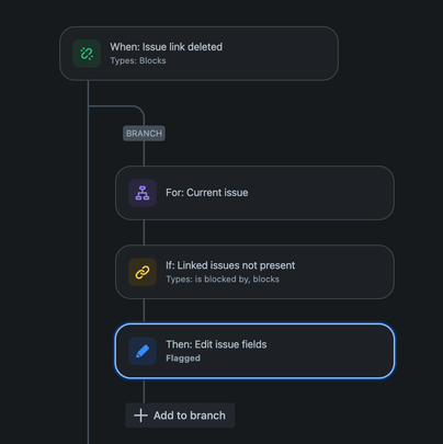

HI @Nils Medina
Try the following automation, set blocks or is blocked by to your need

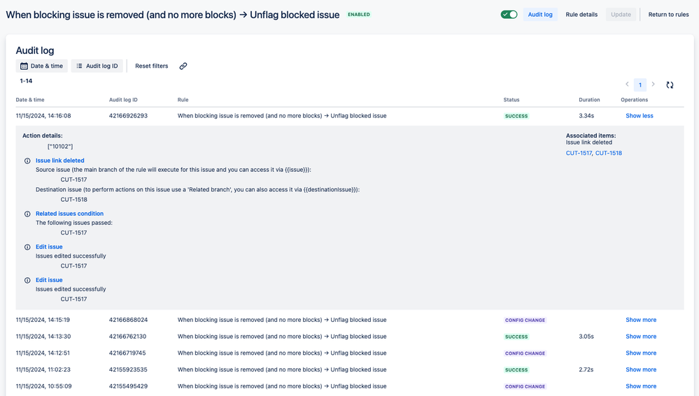

Nils Medina
November 15, 2024
@Marc -Devoteam- that did not work.
Interestingly I just checked the audit log and it marks the automation as working in my tests:
So I thought maybe the issue comes from the action, not the trigger. I added a simple label edit to the rule to validate this assumption, but still nothing happens :/

Marc -Devoteam-
November 15, 2024
Hi @Nils Medina
On which issue are you removing the links, based on that the if in the branch should act?
Try in the branch to remove the option "Blocks"
This will mean that the issue you act on should have a link or links that are set as "Blocks"
The issue is that its tricky to do this based on the link direction and on which issue you are actioning
There is always a risk that someone removed the link from the wrong direction and then the flag doesn't get removed or when linking choosing the wrong link direction
Like Nils Medina likes this

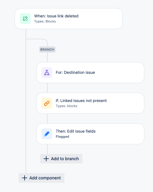

Bill Sheboy
November 15, 2024
Hi @Nils Medina
As @Marc -Devoteam- describes, rules to handle this scenario can be tricky due to from-which-issue the link was removed...and the directional nature of some types of links.
Even more complexity happens when there can be multiple issues "blocking" of any of the issues involved.  Or the "worser" case scenario: circular, link paths!
If you assume no circular, linking paths, and there can be multiple blockings issues for each one, the rule could use branching and related issues conditions:
  • branch to the trigger issue, check if it is "flagged", check if there are any remaining "blocking" issues for it, and if not...only then remove the flag
  • then do the same thing for the destination issue
Kind regards,
Bill
Like # people like this
Nils Medina
November 15, 2024
Ok progress! So by using the "destination issue", I can now unflag the blocked issue when removing a blocker (from either side).
The issue is indeed that this still unflag the blocked issue even when there are still other blockers on it...I would assume the condition "if linked issues not present" would catch that?

Bill Sheboy
November 15, 2024
Progress is good to hear!
Remember that some links are directional.  Thus depending upon the direction, the related issues condition may not find matches if the incorrect direction is picked: "blocks" versus "is blocked by".
If the trigger is on "blocks", the branch on the destination issue should probably check the other direction.

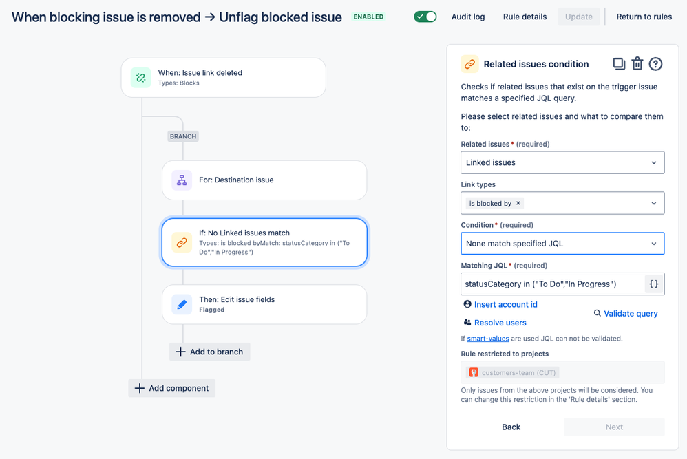

Nils Medina
November 19, 2024
Ok I think I figured it out. This additional rule unflags the blocked issue, only when no other blocking issues are opened. Tested with multiple blocking issues, and while removing the blocking issue from either side.
Thanks again @Marc -Devoteam- and @Bill Sheboy for your help with this!
