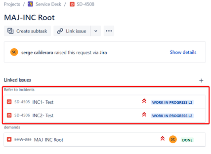

Dear all,
I have a wierd scenario where I could not find a way from cloud to do it while it was possible from server side.
I have the following issue configuration below :
As you can see above I have 2 reference Links "Refer to incidents" and "demands"
The issue which is listed in "demands" link as been trigger to DONE from an other automation rule.
Question :
Is there a way to trigger a rule at this issue level only when the issue in "demand" links has change to DONE
Idea is that when the issue in that link change to DONE, we need to trigger all linked issue in "Refer to Incidents" to status COMPLETED
Any idea how to do this trigger ?

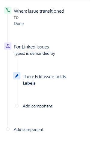

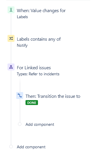

Hi @serge calderara
one approach would be to have two rules like the following:
For project SHW:
For project SD:
To summarize:
As soon as in project SHW an issue is transitioned to done in it's linked issues of type "is demanded by" a label is set.
The rule for project SD listens for the appearance of label "Notify". As soon as this is given all linked issues with type "Refer to incidents" are transitioned to done (given you have status completed also, you could also transition to that one or any other that seems suitable).

Hello @Daniel Ebers , SD-408 should also be set to completed as long as the issue SHW-233 is set to Done.

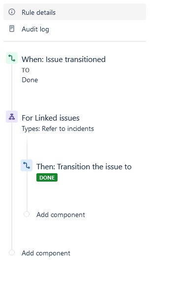

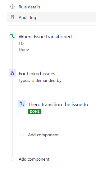

Yes, it also works without labels - here is what I can come up with, using two rules.
For "SHW" project:
For "SD" project:
In a test, it worked very well.
Please note, for the second rule the checkbox "Check to allow other rule actions to trigger this rule. Only enable this if you need this rule to execute in response to another rule." must be checked.

Daniel Ebers
January 26, 2021
Yes, the first rule is with SWH project. It says: when the issue is transitioned to done it will check for any issues with link type "is demanded by". A finding will be transitioned to "done".
Then the second rule (in "SD" project") catches.
This one says: as soon as an issue is transitioned to done (coming from first rule) all linked issues with type "refer to incidents" are transitioned to done (or whatever status is appropriate).
I hope it makes sense now.

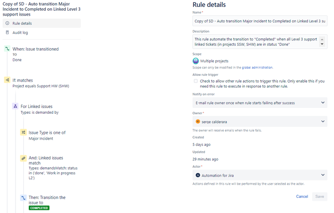

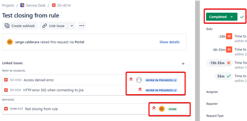

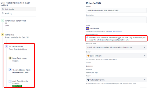

Here is my test result based on your sugestion of 2 rules.
What is happening is that the first rule execute normaly as it should but the rule in SD project did not execute at all, it has not been fired even with the check box in this second rule checked.
As seen above related incident remains in progress
Here is below the complete second rule :
Any idea ?
I noticed that if I transition one incident manually to completed, I have a screen popup that user need to filled up. Does that screen prevent the rule to fire ?

hello @Daniel Ebers , here is below the first rule
Daniel Ebers
January 26, 2021
It is getting a bit complicated I must admit :) But for the moment I believe the problem could be in first rule we are transitioning to status "Completed" but in second rule we are listening for status "Done".
So the second rule would have to start with "When: Issue transitioned TO Completed" :)
If this also does not work out a look into "Audit log" (below Rule details) should tell what is still missing.
serge calderara
January 27, 2021
hello @Daniel Ebers , seems it has work by changing to completed status :-)
Thanks you so much
