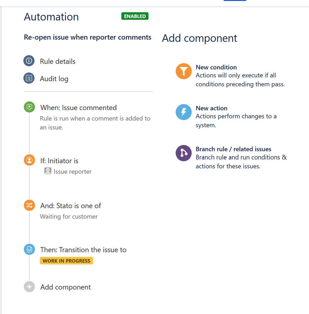

Dear everyone,
I hope this can help someone. In my case our service desk can select the status "waiting for customer" in the workflow and as soon as the customer comments the issue the status return to "work in progress":

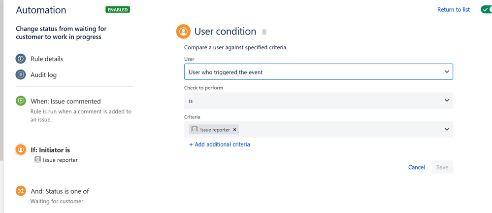

Saurabh_Lakshman
April 30, 2020
@Michele_Lucchese
Hi Michele,
I don't see the "initiator" when I try to set it up. Did you do something different to set that up?
I am facing the issue whereby status is transitioning even when the comment is from automated service desk alert.
I'd like the status to change only when the comment is created by the reporter.
Any ideas regarding this?
Michele_Lucchese
May 2, 2020
Hi Saurabh,
it's called user condition:
You should find it in the standard options.
Regards.
Like Saurabh_Lakshman likes this
Saurabh_Lakshman
May 3, 2020
Thank you! That was helpful.
