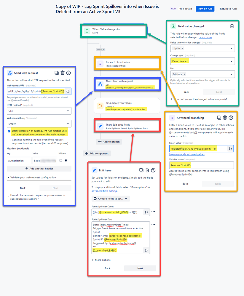

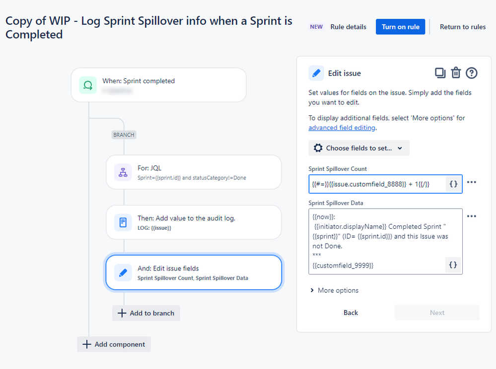

Hi folks, I “think” I may have come up with a solution using a combination of Custom Fields, Automation, and an API call.
I say "think" because I just released it to one of our teams to review/test so I'm not sure if it's working completely yet or not. I figured I'd post it here too so it can be hammered on by others as well. :)
As @Bill Sheboy previously mentioned, this is ultimately a process/learning problem that needs to be addressed. This solution is to only help track the symptom. Thanks for clearly pointing this out, Bill! :)
Solution:
In this solution, I’m tracking two different “spillover” scenarios...
  1. Issues that are committed to a Sprint but are not Done when the Sprint is marked Complete.
  2. Issues that are removed from an “Active” Sprint.
I added two Custom Fields:
  1. Number field named "Sprint Spillover Count" (represented by customfield_8888 in the Automation screenshots below) - It's used to track the number of times an issue is either removed from an Active Sprint or not “Done” when the Sprint is completed.
  2. A Multi-Line Text field named "Sprint Spillover Data" (represented by customfield_9999 in the Automation screenshots below) - It's used to log details about the spillover.
I created two new Automations that populate the new fields:
  1. The first one is triggered when a Sprint is Completed. It will cycle through all of the issues in the Sprint that aren’t Done, increment the count on the "Sprint Spillover Count" field, and log an entry in the "Sprint Spillover Data" field.
  2. The second one is triggered when an issue is removed from an Active Sprint. Similarly, it will increment the count on the "Sprint Spillover Count" field and log the entry in the "Sprint Spillover Data" field.
Automation details for the first Automation:
Automation details for the second Automation:
REVISED (See my comments in THIS SUBSEQUENT REPLY)
Anyhow, I hope this helps. I'll post an update if the team finds any significant issues during their testing. Cheers!

Guy Anela
July 11, 2024
Thanks for the heads up, @Bill Sheboy
Interesting, the {{fieldChange.from}} results have been accurate during my testing (so far), but I'll definitely keep a closer eye on it now.
I did some digging; Is JRACLOUD-81160 the Bug you're referring to? If so, it looks like it may only occur if multiple values are deleted from the field (based on the example in the Bug). If that's the case, I don't think this will be a problem with Sprints, right? Either way, I'll definitely pay closer attention to it.
Also, by the way, this opened my eyes to {{deletedFieldChange.values}} which I believe I can use in place of my For Each.  ...learn something new every day. :)
Thanks again, Bill!
Guy Anela
July 11, 2024
Yep, I just confirmed that I can use {{deletedFieldChange.valueIds}}.
EDIT: I removed the example here since I posted an updated version in my original reply.

Guy Anela
July 12, 2024
I ran into a snag with the Automation that gets Triggered on the Sprint delete. I tested scenarios pertaining to Bulk Edit and Import and it was bombing in cases where multiple Sprints were removed.
Specifically, the web request API call was failing because it was passing multiple ID's in the URL parameter. To address this, I simply added a For Each to loop through the ID's. I'll update the screenshot of the Automation details in my original reply.
Also, I just want to note that the {{deletedFieldChange.valueIds}} smartvalue appears to be reporting the correct values even when multiple Sprints are deleted from the Issue.  ...still keeping a close eye on it though.
Cheers!

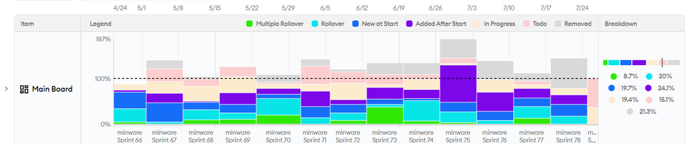

Dan -minware-
August 3, 2023
Hey @abhishek_sharma03 -
If you are open to working with a 3rd party this is available "out of the box" in minware.
Here is a screenshot of our sprint trends reports - you can see rollover (teal) and multi-rollover (green):
The report can be expanded to show the individual tickets / work that is rolling over.
We offer a free trial if you want to check it out!
