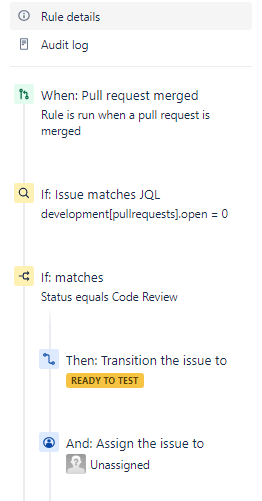

Artur.Cybruch
April 28, 2021
@Timothee Grosjean this has to be done by an administrator of your JIRA Cloud as only they would be able to add this to the automation in JIRA. This can be found by going to "Settings" -> "System" -> scroll to the bottom until you can see "Automation Rules" section. Once inside the automation area, your admins would be able to create a rule like this (obviously, this would need to be customised based on your company needs):

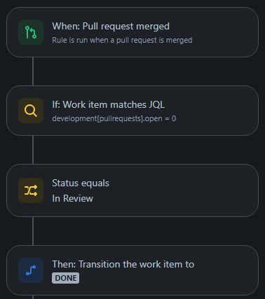

Hi @Artur.Cybruch
I followed your suggestion, but unable to get the desired result. What you are suggesting totally makes sense, but not sure why it is not working for me unlike others. Attached are screenshots of my automation rule and audit log for a merged pull request. Thanks.
