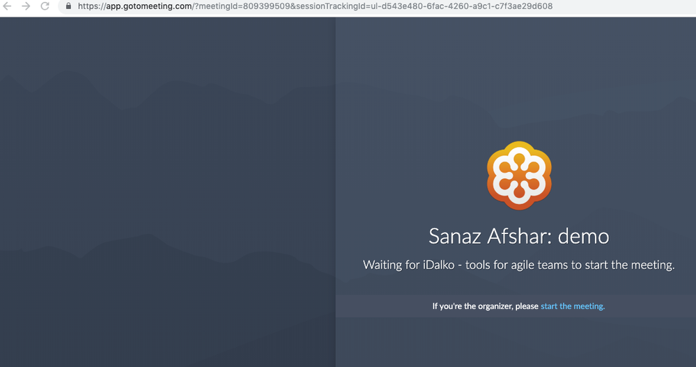

I have booked a demo for today at 2:30, and tried to join to meeting at and no one showed up.
any idea?
best,
Sanaz
Hi Sanaz,
We reviewed our demo backlog and something weird happened during the registration, such that this demo remained unattended.
Can I kindly ask you for another booking?
Thanks,
Francis
