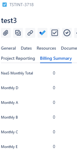

I have 5 Custom Fields and each Custom Field is being used to calculate the Monthly Payment. The default value is set at 0 for all the Custom Fields. When the Workflow transitions to Active the following values are correctly generated
e.g.
Monthly Payment A = 10
Monthly Payment B = 15.67
Monthly Payment C =12
Monthly Payment D = 15
Monthly Payment E = 20
I have created another Custom Field - Monthly Total which is to sum the 5 above.

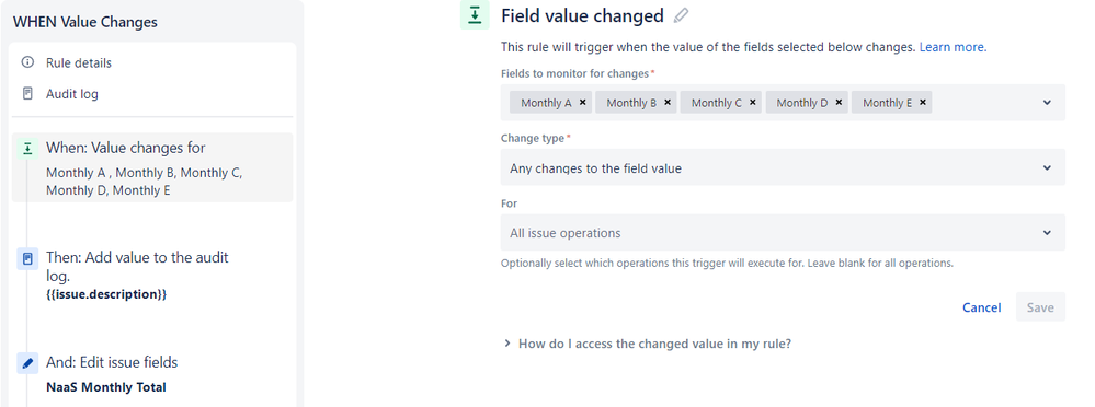

I am using the Automation Rule
When the Value changes for
Monthly Payment A, Monthly Payment B, Monthly Payment C, Monthly Payment D
Monthly Payment E
And: Edit issue fields
Monthly Total
{{#=}}{{issue.Monthly A|0}}  + {{issue.Monthly B|0}} + {{issue.Monthly C|0}} + {{issue.Monthly D |0}} + {{issue.Monthly E|0}}{{/}}
I am not getting any result.  What am I missing?

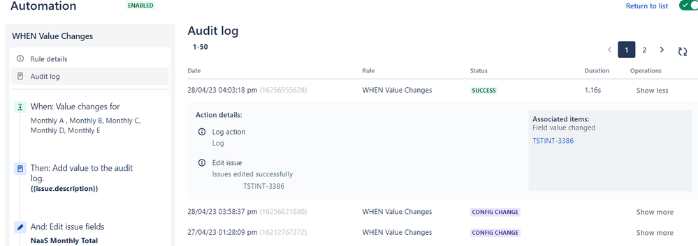

Try adding a log of each of the fields to see if they are returning any values. Also, can you share the rule and the audit log when you run it? I suspect the rule isn't even really running.

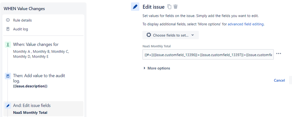

Bola Oye
April 28, 2023
Bola Oye
April 28, 2023
I am not sure if I have the audit log at the right place. I still don't have an output even though the status output is success
John Funk
April 28, 2023

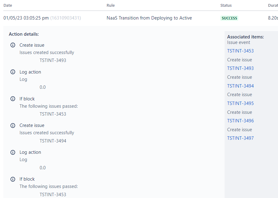

Sorry, I was looking more for the log of the fields that were changing, not the Description field. Make sure you use the Case exactly as the field name. Wanting to see what the values are in those fields.
Bola Oye
May 1, 2023
While I have 0.0 showing on the Log above, the correct values for Monthly A  Monthly B  Monthly C  Monthly D  Monthly E showed up on the form.
John Funk
May 3, 2023
That's definitely the problem then - automation is not properly pulling the values for those fields.
Are you logging the values of the those individual fields? Or the calculated ones?

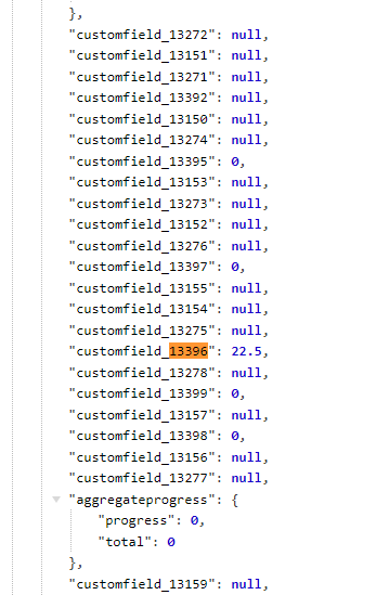

Bola Oye
May 15, 2023

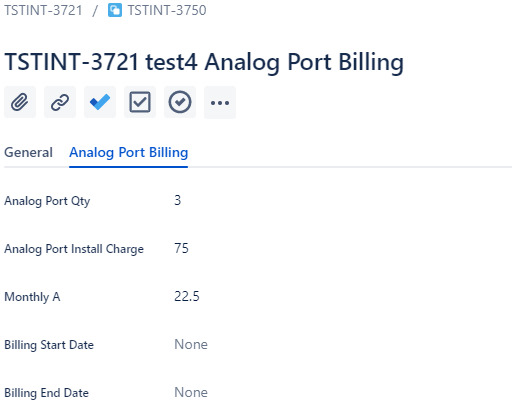

1. I see the Monthly A value in the customized sub-task (I created a different screen) below = 22.5
2. the amount shows up
2. the amount shows up on the form page of the screen
3. I have logged Monthly A, Monthly B still 0.0

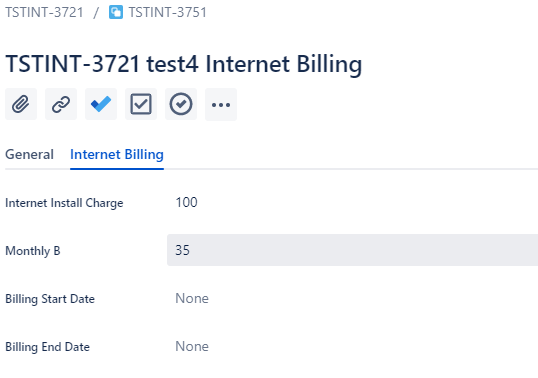

The Monthly B is setup with default of 35
The Monthly A is setup with {{#=}} {{issue.Analog Port Qty}} * 7.5{{/}}
The Total is setup as:
