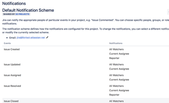

can you share a screenshot of your notification scheme screen?

by default notification exist unless you turn the off. By looking at the notifications for the project it will answer the obvious question. For example here is one I have:

@Naveen, you indicate you have turned "it" off but i'm not sure what "it" means. Maybe you could illustrate this w/ screenshots. At this point you haven't provided a screenshot so I can't assess if this is an obvious issue w/ notifications or not. That said I will simply assume that you have removed ALL notifications in your notification scheme.
Andrew provides two considerations below. If this is about JSD and not JSW then this question is posted to the wrong thread. Please advise which we are dealing w/ here. He also mentions using Notification Helper and for sure you should try that and report back.
Danilo refers to the event fired and if desired you could remove the event fired on creation altogether. Not a normal thing to do and not necessary to prevent notifications generally but you can try it. edit the workflow, select the transition for Create, edit the post functions, select and remove the Event Fired.
