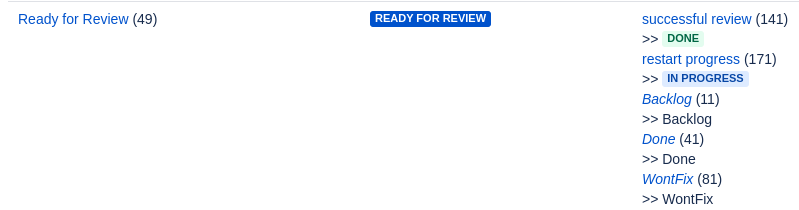

Does that give an indication on what triggers it? The projects workflow is "Software Simplified Workflow for Project BLY" with a note "Generated by JIRA Software version 8.5.0-DAILY20190920183006. This workflow is managed internally by Jira Software. Do not manually modify this workflow."

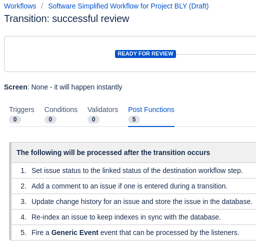

I checked the workflow steps and found a transition "successful review" on the "Ready For Review" step...
but it has no triggers assigned. This is likely the transition triggered when clicking the "successful review" button in the GUI.
