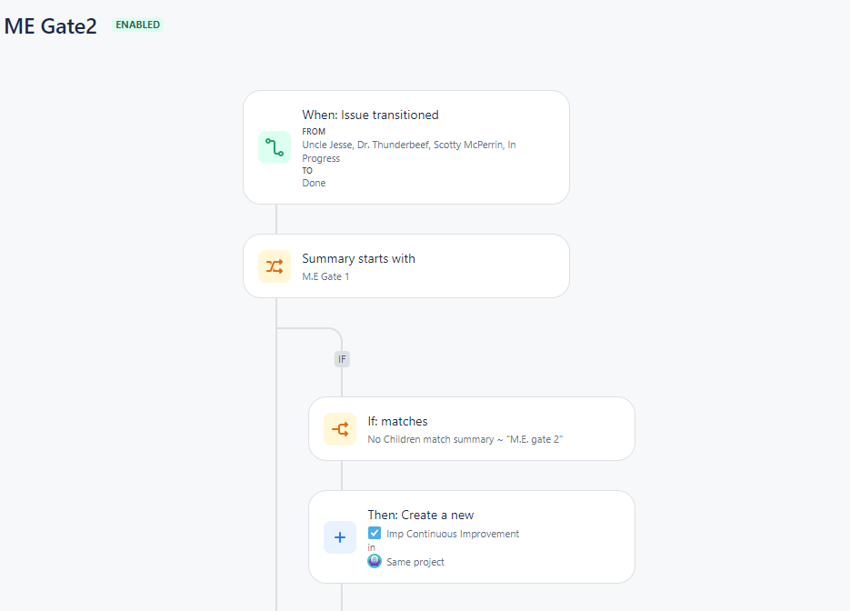

The automation rule used to move the issue to done is shown below:
I need to have this rule in place or at least one similar to cause a chain effect.

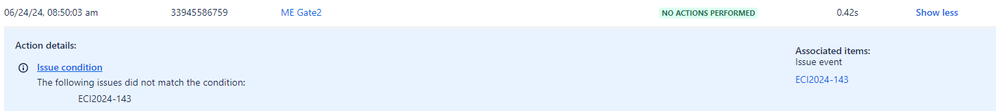

The Rule I am having issues with is the rule following the epic creation and the first issue creation. I have included the audit log and the actual steps of the rule.
I am having issues with the issue field condition; I have tried both summary and issue type and get the same error each time.

Unfortunately it's difficult to diagnose the issue without further information. When you say you have tried issue type in the condition, what do you mean by that?
Does the automation work as expected if you remove that condition and test it?
Could you also please confirm the exact value of the issue ECI2024-143's summary?

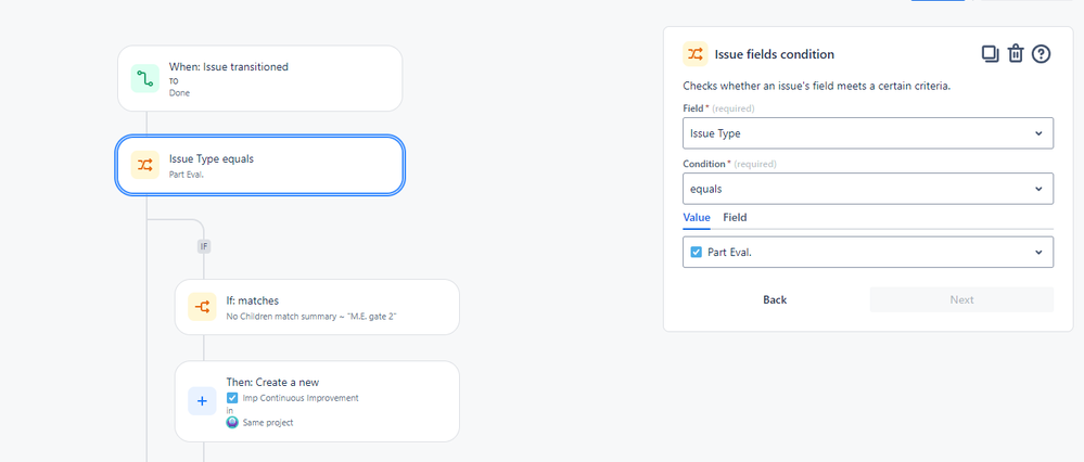

As in issue type I change the condition box to issue type instead of summary and change it to the issue type that is moving.

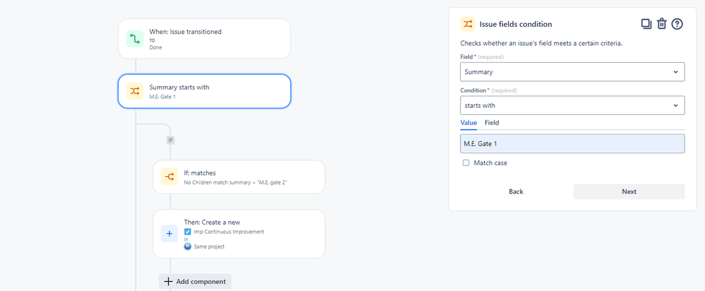

Could you please provide a screenshot of the configuration of the Summary starts with condition?
Lex Baldridge
June 24, 2024
Here is what it looks like with the issue type:
And this is what it looks like with the summary:

In addition, if I manual click from in progress to done it will trigger and follow the rule. It is just when it is automated to move to done is when the rule fails.

By default, automations will not be triggered by actions from other automations.
Please enable the checkbox labelled "Check to allow other rule actions to trigger this rule." Which can be found when viewing the automation rule details.
This should solve your problem
