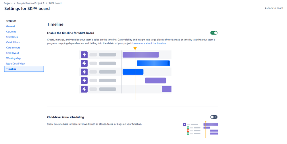

Hi @Thierry Bouvet , thanks for your question.
Is this a plan inside of a project? If so, please check the board configuration settings here -
that the child-level issue scheduling is enabled, the second option here ^
Does this help at all?

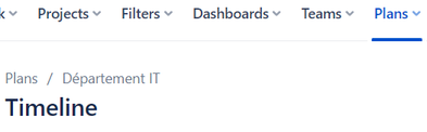

It is not inside a project, It is timeline in "Plans" menu:

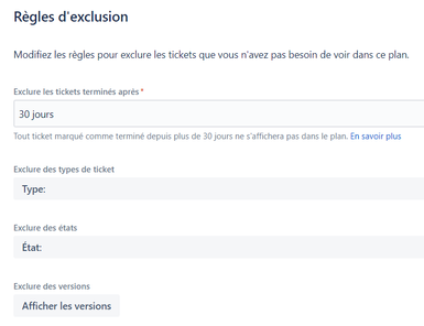

Please can you check in the Plan settings that nothing is being excluded? If you can see other Subtasks, okay, they are not being excluded by type, but can you check please there aren't other restrictions in place? Including the date range to be included.

Hi @Thierry Bouvet , are the subtasks more than 30 days old?
Thierry Bouvet
November 7, 2023
Hi @Valerie Knapp
No the tasks were created 2 weeks ago.

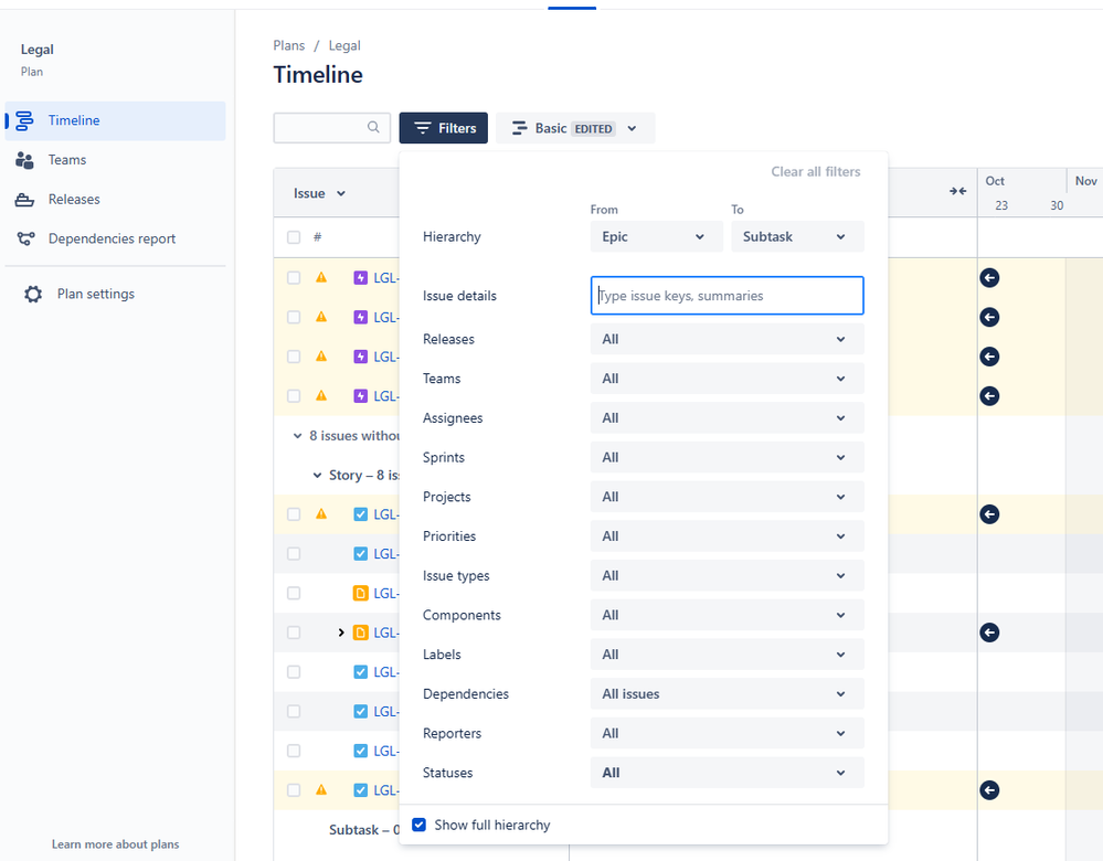

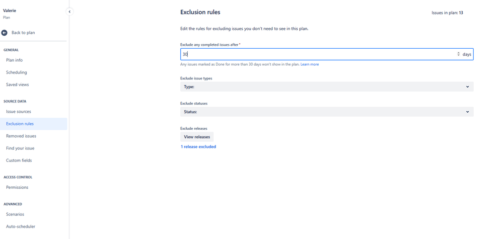

Hi @Thierry Bouvet , thanks for your patience. Do you have this option here, in the settings -

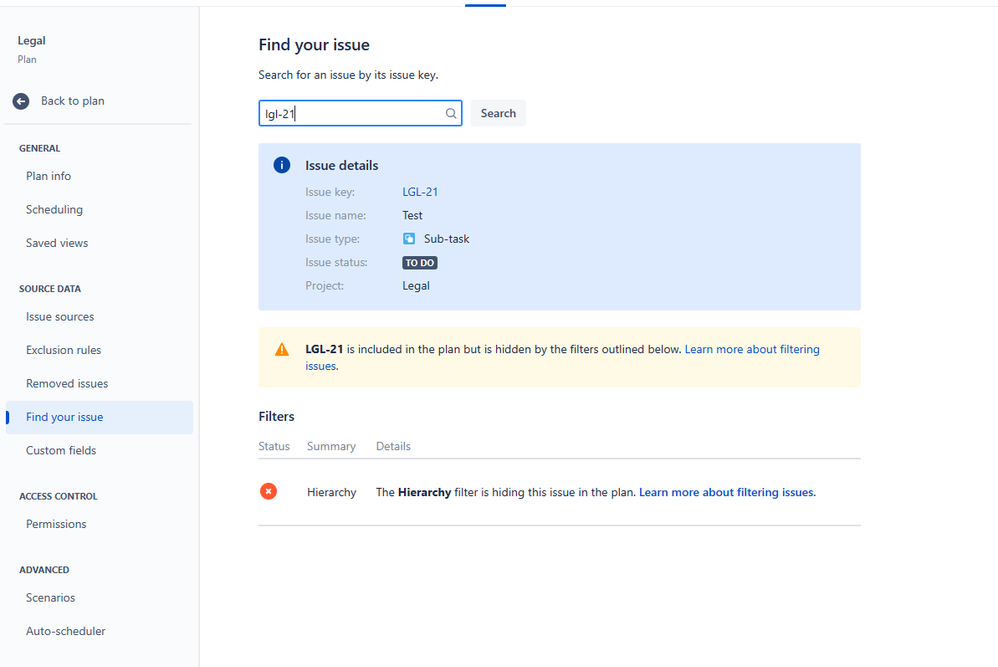

Please can you check what the result is for an issue key of one of the Sub-tasks?
Valerie Knapp
November 7, 2023
When I returned to the plan, when I modify the settings under Filter to include Subtasks in the hierarchy, I see the Sub-task I created

In the menu "Find issue", it seems to be ok :
But, my subtask are in the bottom (tasks not linked), they don't appear in the bottom of the parent key :
Valerie Knapp
November 7, 2023
Hi @Thierry Bouvet , thanks for your comment. I don't seem to be able to replicate this problem. I will escalate this to Atlassian so we can get you some help.
