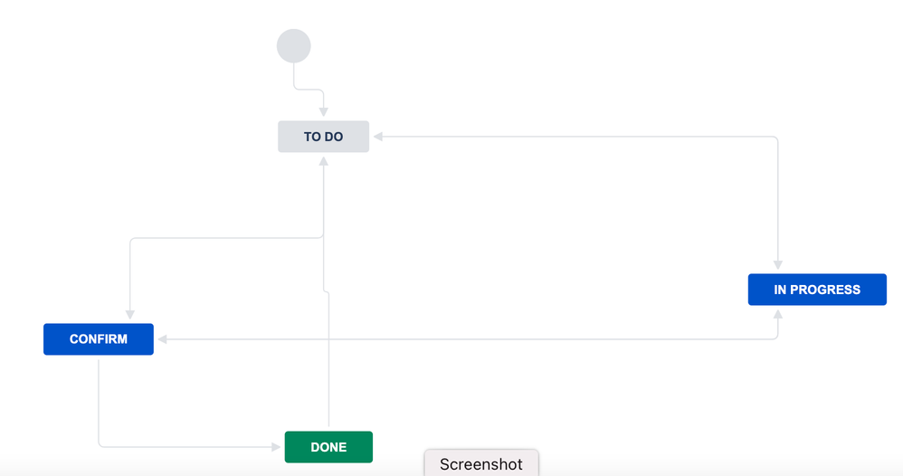

Hello @Ed Parry
You should have a similar workflow to the following.
Simply add "Confirm" status and change the connections between statuses. Click on the transition from In Progress -> Done, drag it, and move to Confirm. Then from Confirm to Done.
Delete all connections to Done except Confirm->Done.

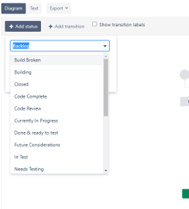

Unfortunately I don't have option to add a "confirm" status to the workflow
My list of available status is shown below ↓
The fact that very similar Jira products have very similar but significant enough differences is extremely confusing and frustrating.
It looks like you should be able to do things but then they aren't available in the particular version you are working in.
