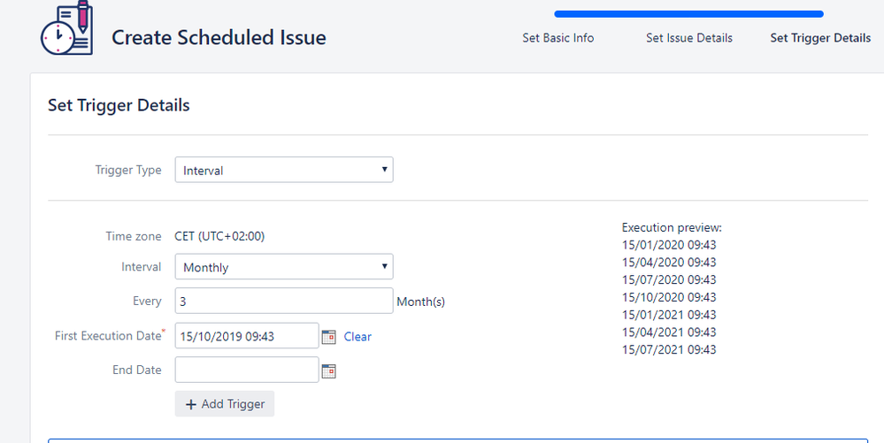

Mohamed Benziane
October 15, 2019
Hello Marc,
You can use "interval" in the "trigger type" field.
If you need a cron instead of interval you can take a look at this page
http://www.quartz-scheduler.org/documentation/2.3.1-SNAPSHOT/tutorials/tutorial-lesson-06.html
