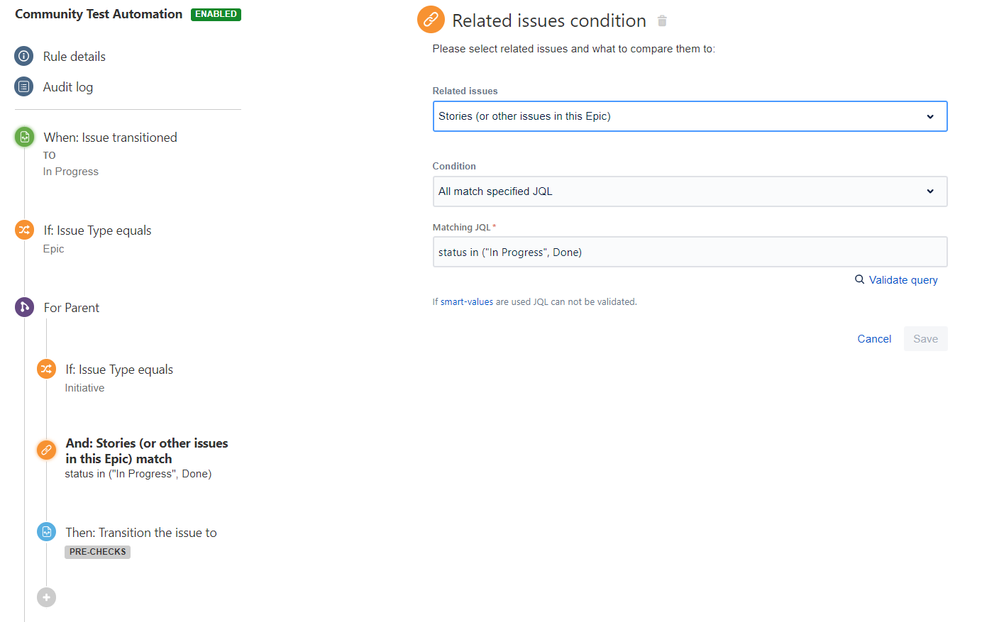

Thanks for clearly explaining your use case and requirements. This should be quite easily achievable using Automation. It might be depending on the version of Jira and/or the Automation plugin for Data Center, but in my 9.12 Jira DC test setup this should work for the In Progress status.

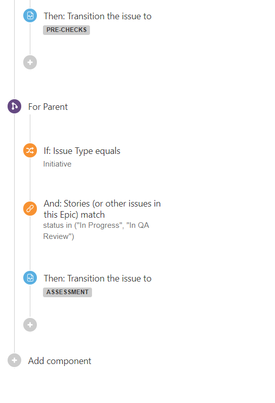

Similarly, you could create a copy of this rule for the Assessment setup, or try to combine it in one automation rule with another Parent branch, like so:

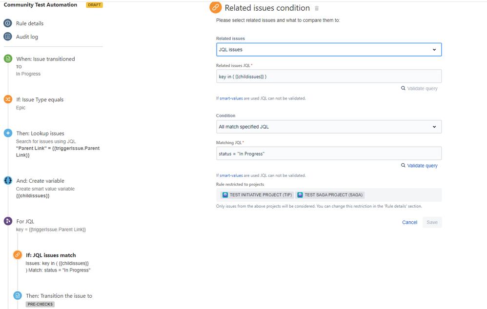

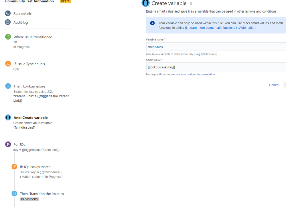

The solution I found:
JQL used in the lookup issues step: "Parent Link" = {{triggerIssue.Parent Link}}
JQL used in the branch: key in ( {{childissues}} )

My approach was as follows:
  1. Lookup all issues that have 'Parent Link' as 'triggerissue.Parent Link' (a.k.a.: all Epics that have the same Initiative as parent)
  2. Create a variable for the results of this lookup called childissues (I checked with the audit log, it saves multiple items correctly)
  3. Then, the branch only applies to the single Initiative that needs attention. So, 'key = Parent Link' results in the actual Initiative ticket that needs to be checked
  4. Then, when in the branch, check if the condition is true that the child issues are all 'In Progress' (but maybe this could be moved outside the branch as well, don't know if that would matter?).

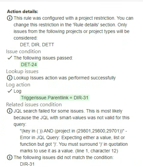

  • Audit log says:
  1. Issue Condition: the following issues passed: <epic issue key in Project C1>
  2. Lookup issues action was performed successfully.
  3. Related issues condition: the following issues did not match the condition: <initiative issuekey of Project P>
Second, I followed Bill's suggestion by making the changes in Create Variable in Hans Rule and observed that:
  • Audit log:
  1. Issue condition: the following issues passed. <epic issuekey of Project C1>
  3. Related issue condition:
    JQL search failed for some issues. This is most likely because the JQL with smart-values was not valid for this query:
    "(key in ()) AND (project in (<projid P, projid C1, projid C2>)" - Error in JQL Query: Expecting either a value, list or function but got ')'. You must surround ')' in quotation marks to use it as a value. (line 1, character 12).
  4. The following issues did not match the condition: <initiative issuekey of Project p>
Please guide me further if I am missing any configuration in the Rule creation, I will make the necessary changes and then share my observations with you.

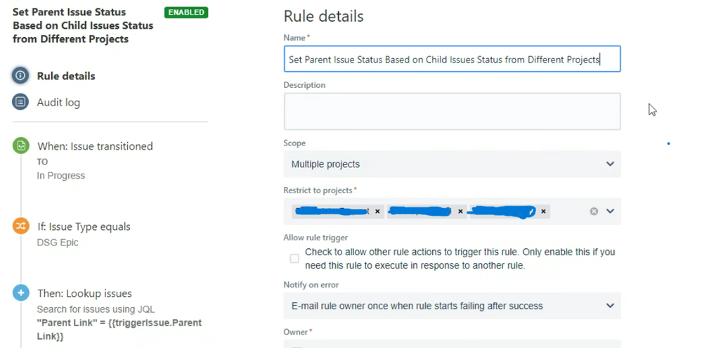

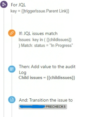

I would like to share the screenshots of my Rule as requested below:
1) This is Rule details of my Rule:
2) This is the Audit log after configuring Rule and executing the required action:

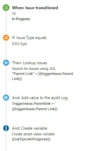

3) This is the first part of the Rule:
4) This is the second part of the Rule:
I have tried multiple times to configure the rule as per your suggestions but I am unable to see Status update of Parent Issue in Project P based on the Status update of Child Issues in Project C1 and Project C2.
Please guide me further with an appropriate solution.

Bill Sheboy
August 5, 2024
To help with context, please post an image of the entire rule in one picture and of the entire audit log details showing the rule run in one picture.
You can get those into one image using either an app or a browser extension which supports scrolling page image capture.
Next, if you view the audit log and compare to the rule steps shown {{childissues}} is empty.  Where are you getting / setting the value of that smart value?
