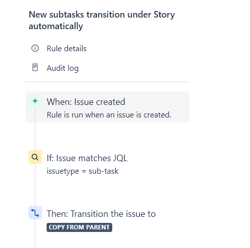

Derek F
January 24, 2023
This is the rule.  Doesn't even fire when a sub-task is created by a rule.
Like Nic Brough -Adaptavist- likes this
January 24, 2023
Sorry I misread your first post about where the automation was.
Automations don't trigger other automation, as you could easily create an unintended cascade or even infinite recursion if you get it wrong.
Click on the "rule details" in your screenshot, and look for the "Allow rule trigger" check box.
I'm usually very cautious with this - I save the rule, then go back into the rule details so I can quickly untick it if I need to.  Then test the rule in another window or tab!  I don't know if there is now recursion protection in there, but I did manage to take out a (server) system with an early version of automation!
Derek F
January 25, 2023
Thanks Nic -- I had always overlooked that checkbox.  Problem solved :)
