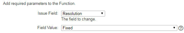

you have to set the resolution in your workflow.
Add a workflow function "Update issue field" to any transition which ends in a closed status (e.g. done or won't work):
For any of your transitions which starts in a closed state (e.g. reopen) add the function "Update issue field" and clear the resolution.

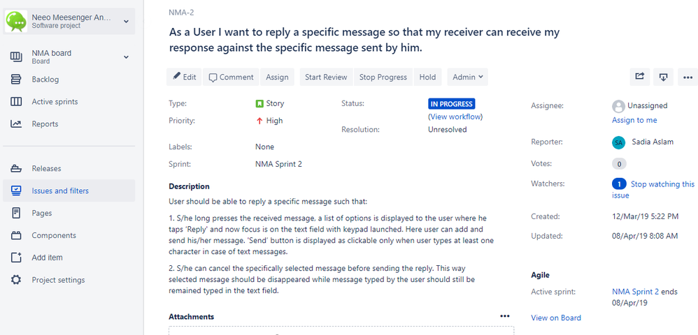

Thanks @Thomas Schlegel I have implemented the above solution but resolution field is not displaying on issue screen. How to display it? Please guide.
I don't understand what you're referring to by 'on issue screen'. In both of the the screen shots the resolution is displayed. You need to tell us what screen you think it should be on. It can't be on the create screen, edit screen, or any transition screen except the one where you want it set.
@Joe Pitt I need to display Resolution field very after an issue is created successfully. I think these are edit and view screens where I want to get the resolution field displayed.
It always appears on the issue details. there is no reason to put it on any screen except where it is to be set.
Resolution Field can't be made optional. It is ALWAYS required when presented on any screen except the view screen. Putting it on the view screen is pointless because it always appears on the issue details. DO NOT put the field on any screen except the one presented in the transition where it is to be set. Resolution is a special field in JIRA. It has an initial value of ‘Unresolved’, which means the field is NULL in the database. It is ALWAYS required when it appears on the screen. ONLY display it on the screen during a transition to the status where you want it set. Once it is set the issue ID will appear with as strikethrough. If you re-open an issue the transition from closed to reopen needs to have a post function to CLEAR the resolution field to set it back to Unresolved.
@Joe Pitt Please observe the screen shots above. That's actually requirement and I have to customize it as per resolution field is displaying during all phases (Statuses) of workflow displayed in the screen shots. You can see the value of Resolution field is appearing as Unresolved when status is To Do, In Progress, Ready to Be Tested while Resolution is set as Done only when the status is done. Now Please guide how can I do this.
this is the default behaviour. The resolution field is always visible and unless you change it, it will show the value "Unresolved". You don't have to do anything.
Your screenshots are showing the default behaviour, exactly what you're describing. So if these screenshots do not show your problem, could you please upload screenshots of your problem so we can get a better understanding of the problem?

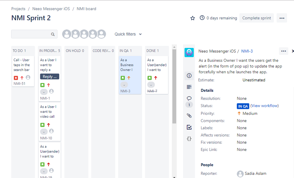

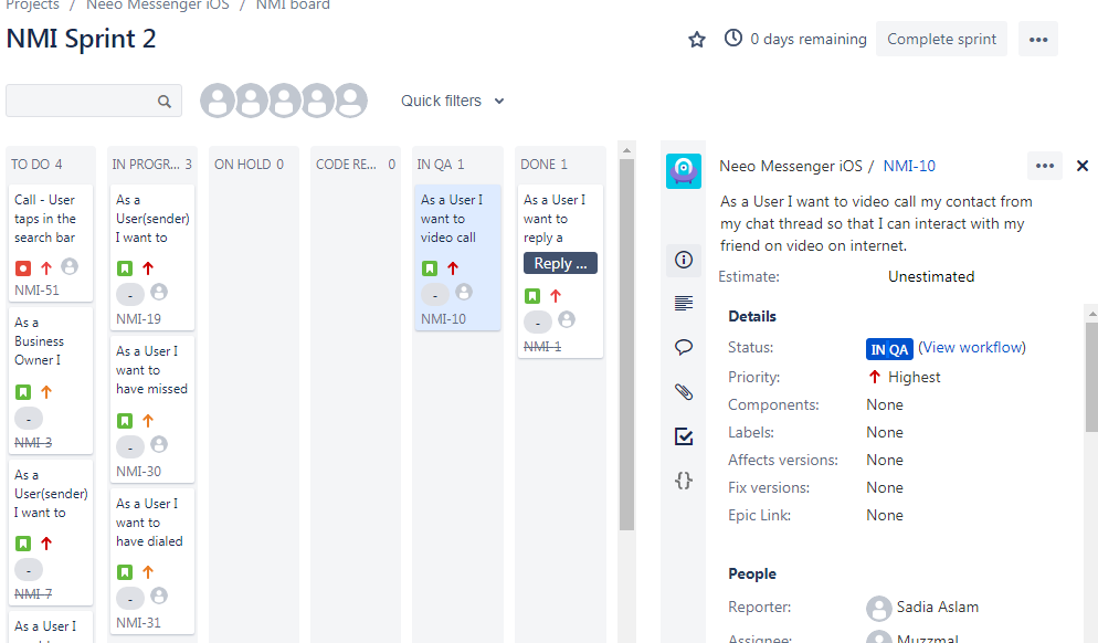

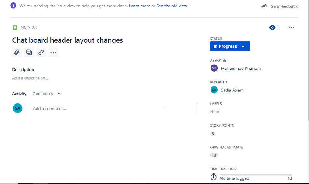

Resolution field is not displaying currently. Here are the screen shots:
As @Thomas Schlegel says, this is normal behavior. It sounds like you want the resolution field to show the status. The is not what it is for. It should appear as unresolved until you set it when closing the issue. Any value other than the default of unresolved will cause the issue to be considered resolved and the assigned to me filter and several others won't work as desired.

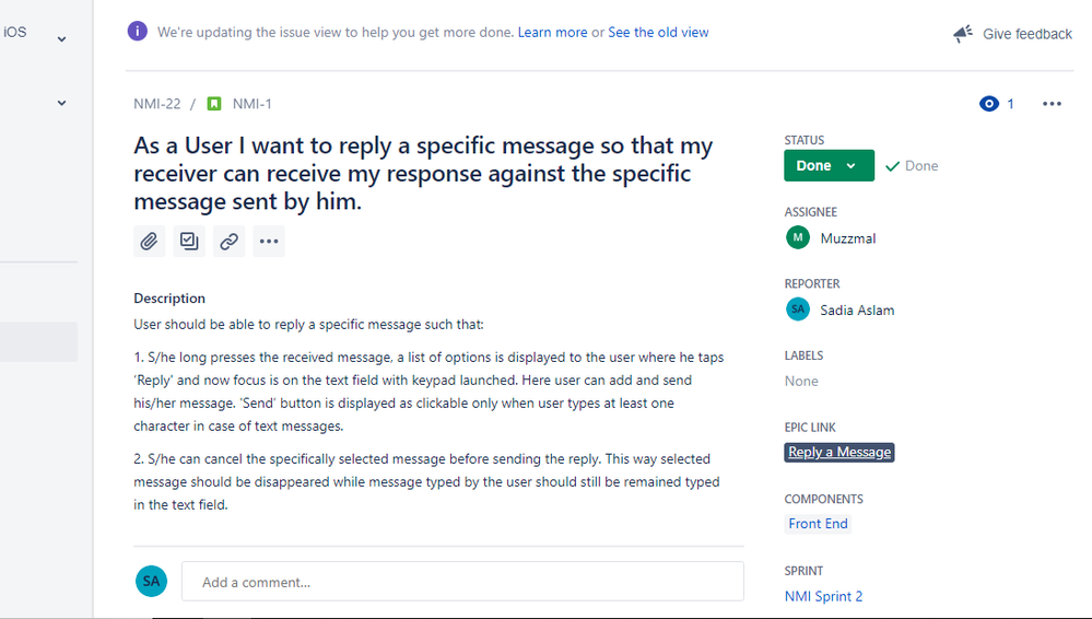

thank you for the new screenshots. This makes clear that you are using the "New Issue View" in Jira - this view indeed is showing the resolution only, if it is set. Then it looks like this:
As far as I know, you can change this behaviour only by switching off the new issue view in your personal settings.

Thanks for your response. Yes, I toggled Lab to view the issue in dialog form. Now I have searched everywhere but I'm unable to find this option to revert to see issue in side bar. Please guide where I can find Lab toggle. I'm desperate to see the resolution field on issue screen.
Thanks for being there. It worked. Resolution field is displaying but as you communicated earlier it's value should be shown as 'Unresolved' by default when it's not set. In my case it's displaying 'None' for already existing and newly added issue in sprint. Please guide how to make it display as unresolved when it's not set. Also I have set the resolution to Done on close transition but it's also displaying resolution value to None.
If you don't set a resolution, the field is showing "Unresolved" - I have just tested this in my cloud testing environment.

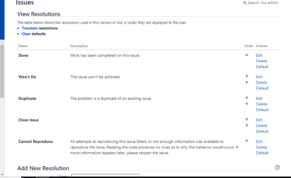

Could you please post a screenshot of your resolutions definitions? You can find them here:
https://<your-url>.atlassian.net/secure/admin/ViewResolutions.jspa
Just to make sure, there's no "None" defined in your configuration.

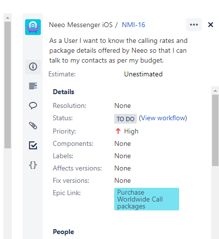

Thanks for providing support. It's OK. I just wanna get rid of this issue. To your questions:
1. yes, when resolution field was not displaying on the screen, I tried to add it as a custom field.

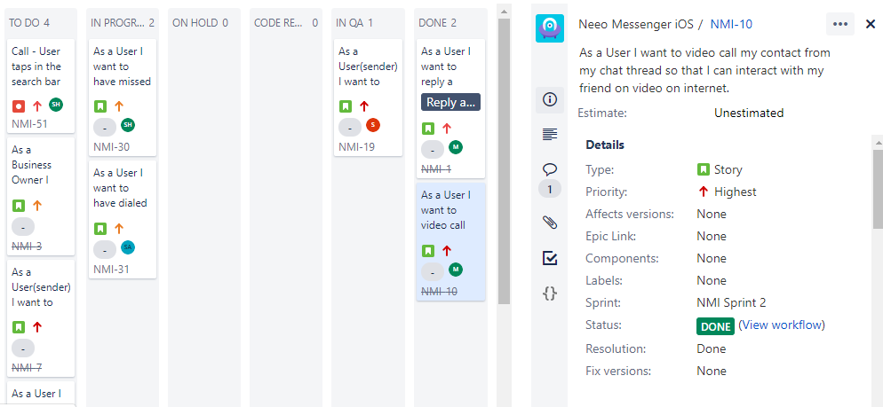

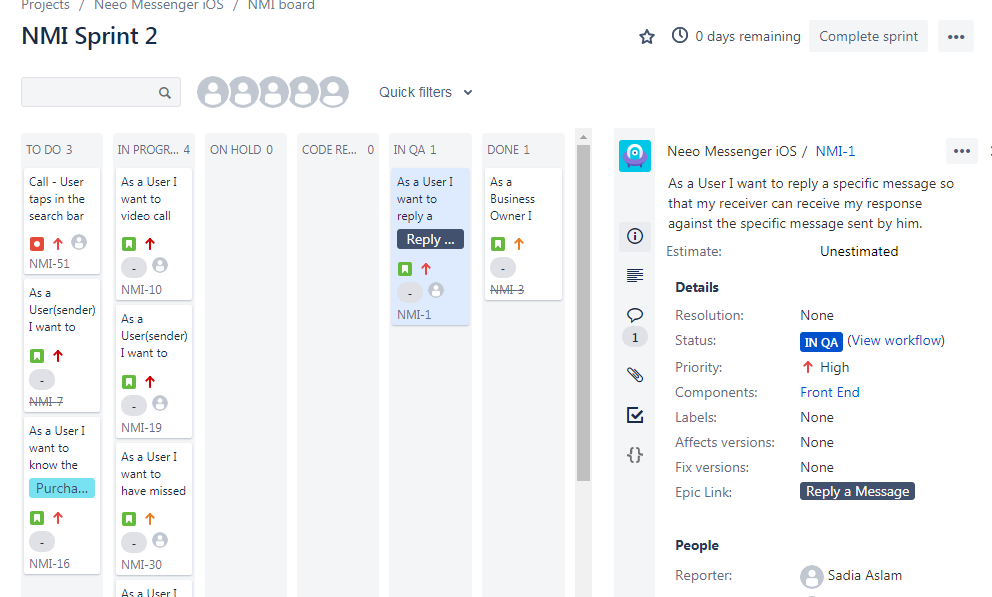

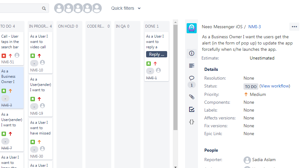

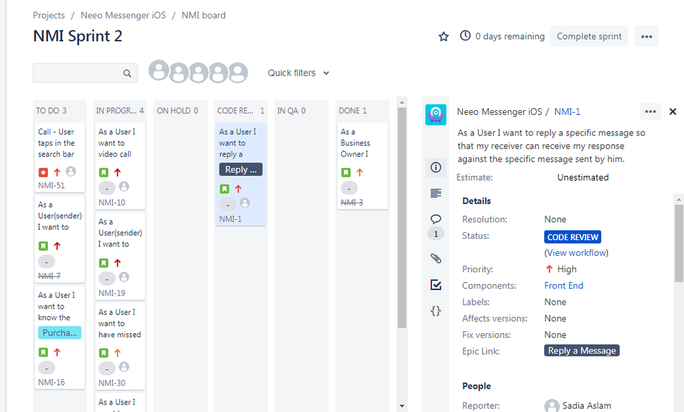

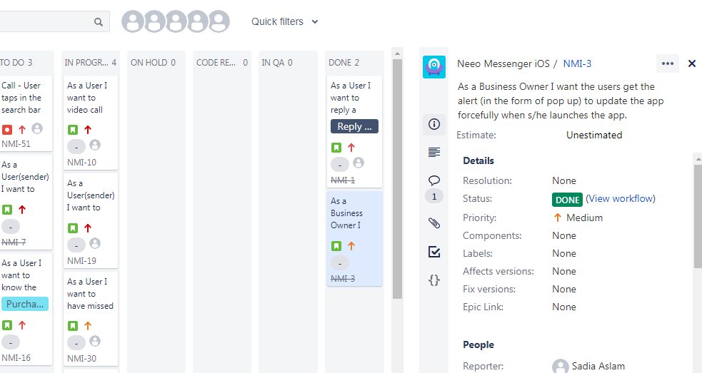

2. I have moved NMI-3 from 'Code Review' to 'In QA'. Then from 'In QA' to 'Done'. Then from 'Done' to 'To Do'. Here are the screen shots of all the phases:
Then, it's clear. What you see on your view is not the system field but your own custom field. That's why you see "None" except of Unresolved.
You should delete your own custom resolution field to get back the system field.
I have deleted the custom Resolution field and it's got disappeared from the screen as well. But still the system field is not displaying on the issue view screen. How can I make it displayed?

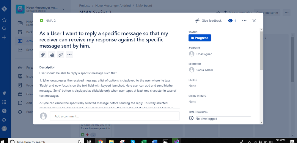

But still there is something to achieve yet. It's requirement to show the issue in dialog view. It's also required to provide buttons for necessary actions and statuses in dialog view which are not displaying in sidebar view. What I want to achieve is displayed in the screen shot below. Please guide how to open an issue in dialog form without effecting Resolution field.
@Thomas Schlegel @Jack Brickey
Please provide the solution for the above ASAP. I have to meet timelines.
Just click on the issue key in the sidebar dialog - then you will see the full dialog.
It's happening some other way. First this UX is lengthy and time taking to move to and fro between issues. Second It redirscts the user to another screen and then he has to come back to board. Like:
What my company wants me is: as soon as user clicks an issue from board, issue is opened up in a pop up box and user closes it to get back to board.

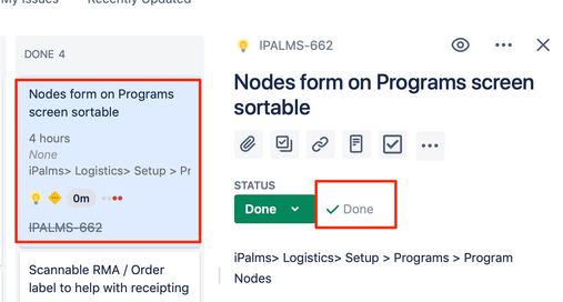

Correct. Dialog view works in Labs only and with Labs on the Resolution will not display until the issue is complete. The idea here, and I agree, Resolution only applies to completed issues. If you want dialog enable labs.

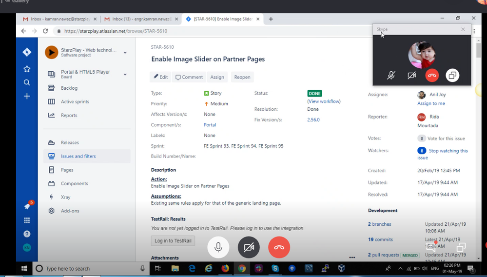

The demo shared with me had both of the features, issue can be view in dialog and Resolution is displaying all the while. Let me share the video after a while. I'm sure there would be some solution.

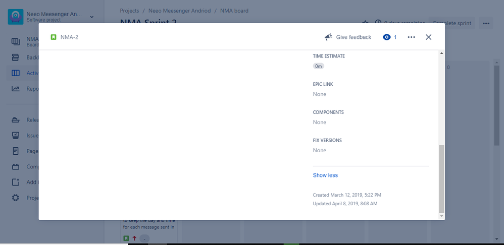

I have put the Labs feature on. As expected it should make the issue view in dialog form and Resolution will be no more visible. But when I click the issue number, issue should be viewed in new tab and resolution field should be displayed as shown in the following link: https://www.loom.com/share/80e00eb5afdf4ff0821cc4ba73d0decd
In my case, Resolution field is not displaying on the issue screen opened in a new tab as well after switching the Labs feature on. Please guide how to display it.

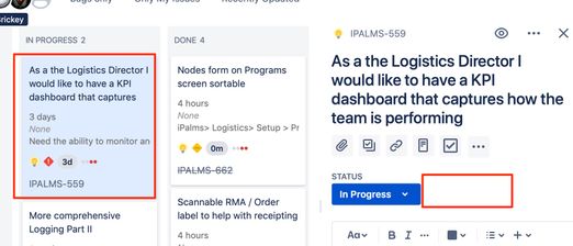

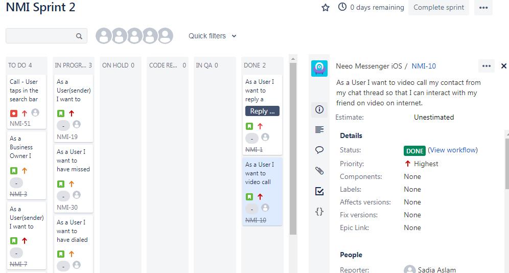

@Sadia Aslam , in Labs mode you will only see the resolution when it is in the final Done (right most) column. In which case the resolution will be right next to the status as below depicts.
when the issue is not done you will see this...
Resolution field was displaying on the screen in the image. After switching to labs mode, it got disappeared. All the clickables of the screen and transitions were displaying as buttons on the top of the screen. After switching to Labs mode all the buttons are also vanished. Even I created new tickets but in vain.
See in image below how it was looking like before moving to Labs mode.
Even view workflow link has got missed.
Displaying issue in dialog + Resolution field together has become messy for me.

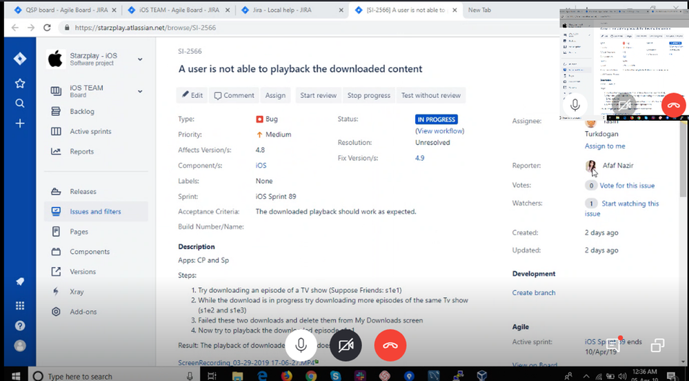

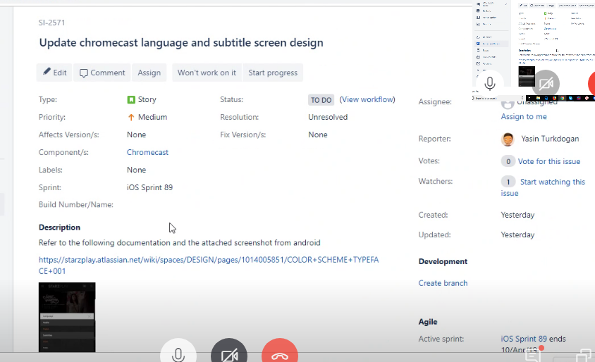

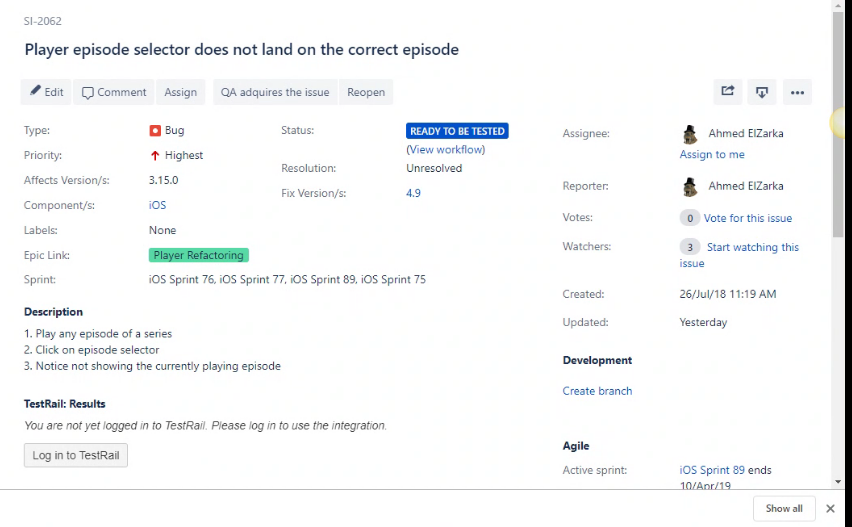

Gentlemen! I have just received the video displaying the requirement clearly i.e. issue can be viewed in dialog form and clicking on issue number resolution field can be displayed during all the phases of the workflow. Here is the video link: https://www.loom.com/share/1505d2bb67134d2bb42ea35c84084d3b
I have shown how it's happening in jira what I described earlier. Now please you people guide me how can I achieve this.
I can't guide you, because I've never seen anything like this. You could give feedback to Atlassian via the "Give Feedback" - Button, but I don't know, how I should help you further. What you want to achieve is (in my opinion and as far as I know) not possible.
I think @Jack Brickey and I we tried to guide and explain here as much as we can. I'm sorry.
thank your for the video. What I am seeing is that you have Jira Labs on which is clear because when you click on the done issue at the end of the video then the resolution is showing beside the status. You have configured to use Dialog view instead of the sidebar detailed view. So all that is consistent with my expectations. The one other thing that you have shown is when you click on the actual issuekey in the card then it is opening a new tab and it is displaying the "old view". I suspect you are causing the issue to open in the new tab by using the keyboard, e.g. on Mac CMD-click will do this. Finally, this view is opening on the "old issue view" vs. the "new issue view". This is important because in the old view the resolution will always be displayed. In the new issue view AND the dialog issue view the Resolution will not be displayed until the issue is DONE. However, I would debate that if there is not resolution (i.e. it is unresolved) the not displaying makes sense and is the same as displaying 'resolution = unresolved'.
I hope this brings this discussion to a close as I'm unsure what else I can add/explain at this point.
