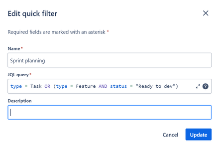

Here is a screenshot before I save the Quick Filter:

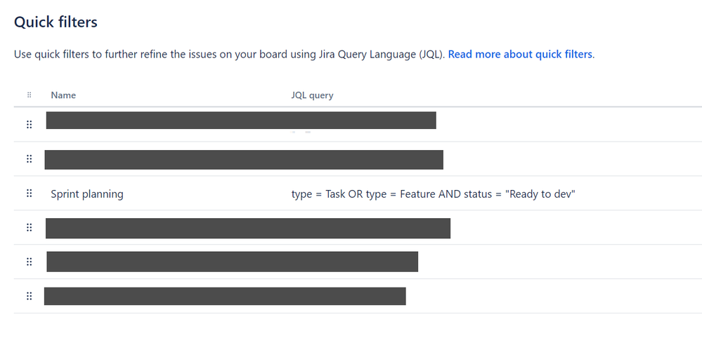

Here is a screenshot after I click "Update":
As you can see, the parentheses aren't saved. When I open it again, the parentheses aren't there. And, when I refresh my board and use the filter, only tasks appear.
