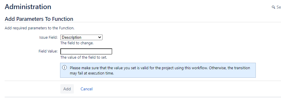

hi @sergey.guba ,
If you using different workflows for Bug and Story. This may be helpful.
1. Go to workflow
2. Edit
3. Select "create" Transition.
4. Post function
5. Update issue field
6. select "Description"
Enter your required data in "Field Value".
7. ADD
8. Save Workflow
9. try to create a new Story / Bug
10. After ticket created. you will able find the required info.
