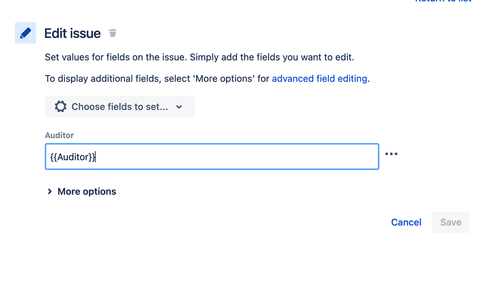

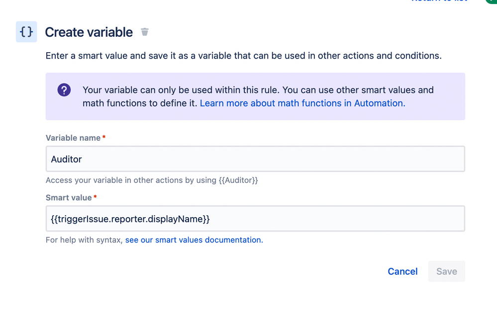

Wendy Chen
July 13, 2022
Is this how I set the variable up? The second image is trying to edit the Auditor field of the epic issue that is created.
Screen Shot 2022-07-13 at 10.01.52 AM.pngScreen Shot 2022-07-13 at 10.01.59 AM.png

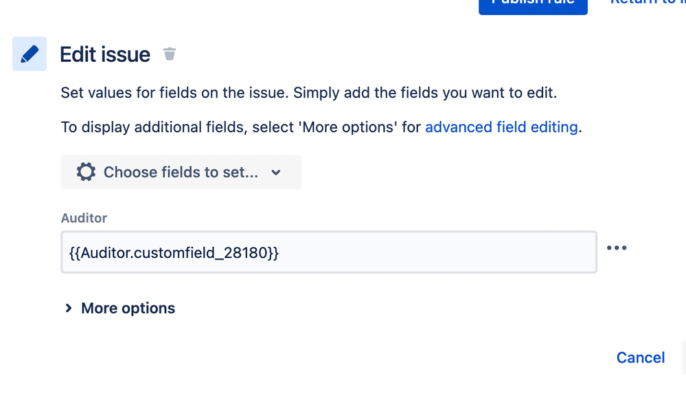

Wendy Chen
July 13, 2022
Would I change it to this?
Walter Buggenhout
July 13, 2022
No, you must ensure that the auditor custom field is present on the create issue screen in the project where you want to create your issues (or on the edit screen if you are trying to edit existing issues).
Navigate to the project where you are trying to create issues, navigate to project settings > screens, locate the screen scheme used for the issue type you need and make sure the custom field is on the create screen.

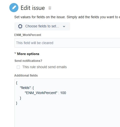

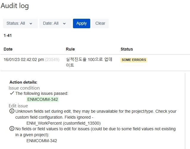

Hi
In my case, I am trying to update value to a number field. Can you advice for me?
JIRA Agent user has a administrator role, and the custom field is in a field configuration scheme of this project and screen of this issue type.
Bill Sheboy
January 16, 2023
Hi @jun lee
Have you confirmed the smart value for your field to use in the JSON advanced edit?  Please note that the smart value may not exactly match the name of the field on the screen or what is shown in drop-down lists.
You can find and confirm the smart values for supported fields using this how-to article: https://support.atlassian.com/cloud-automation/docs/find-the-smart-value-for-a-field/
Kind regards,
Bill

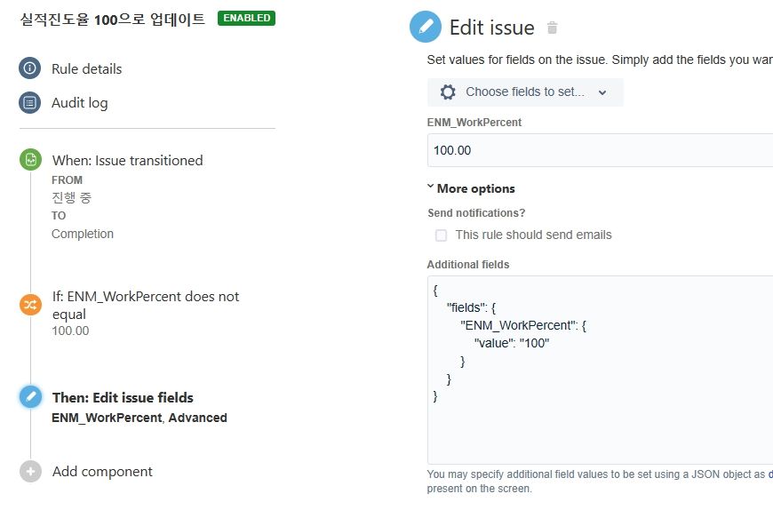

jun lee
January 16, 2023
Hi
The custom field has not smart value. I can find just name of the filed as
"customfield_13500":"ENM_WorkPercent"
from xxx/jira/rest/api/2/issue/ENMCOMM-340?expand=names.
As I mentioned before, it is a number field.  Is number field has smart value, too?
Bill Sheboy
January 17, 2023
Based on what you show, the custom fieldname or ID will work as a supported smart value.  Please try using this example to set a number field with your JSON expression:
https://support.atlassian.com/cloud-automation/docs/advanced-field-editing-using-json/#Number-custom-field

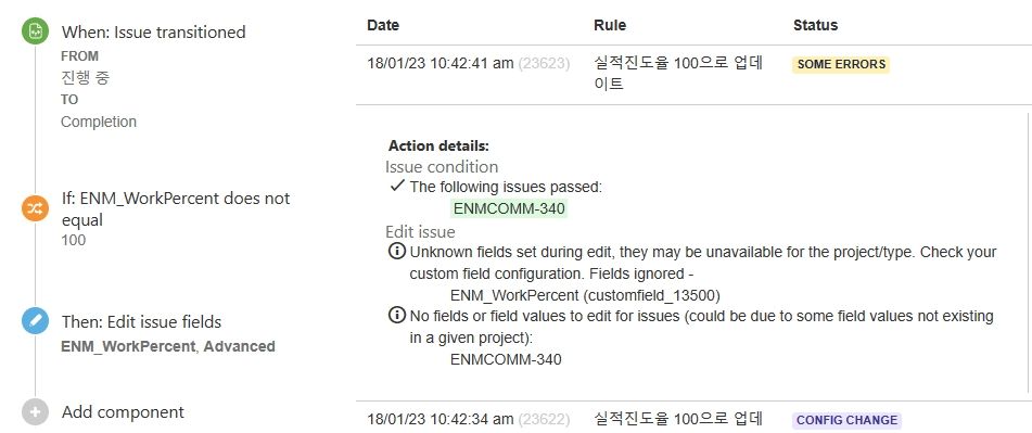

jun lee
January 17, 2023
It sill doesn't work.

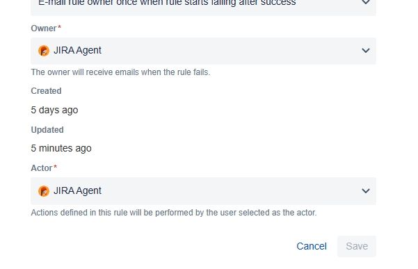

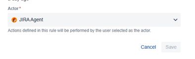

Bill Sheboy
January 18, 2023

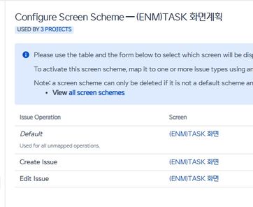

Is your field defined on the edit view?  When it is not present a field cannot be edited by a rule.
Who is the rule actor (i.e. user) in the details section of the rule?  Has this been changed from the default of "Automation for Jira"?
jun lee
January 18, 2023
the field defined on create, and edit screen. Actor is Jira agent has an administrator role.

Bill Sheboy
January 19, 2023
You seem to have covered all of the things I know which could cause this symptom.
At this point I recommend working with your Site Admin to submit a ticket to Atlassian Support for assistance.  If you are using a paid license for Jira the admin can do that here: https://support.atlassian.com/contact/#/
