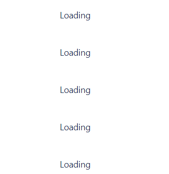

Some how I can get the data from browser console. But what happen in UI is just "Loading" and "Loading".
Could you please tell me what is the problem with my config and how to solve that? Any help would be appreciated
