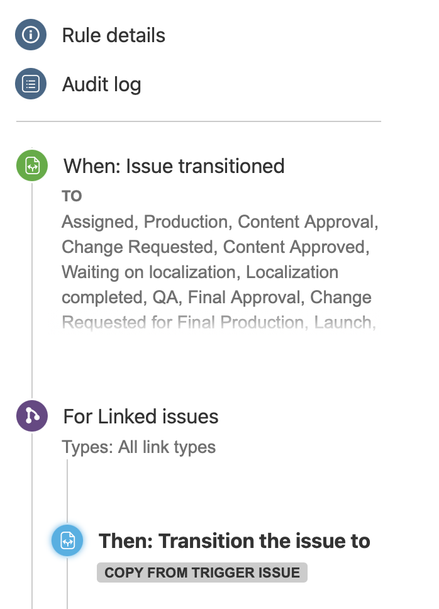

This is the rule I currently set, can you take a look and let me know where it went wrong?
The field I am planning to sync is "status" only. However, based on this rule, the tickets within project A are also update status whenever they have linked issue as cloned which is not planned.
FYI: As the ticket in project B is cloned from project A, I set the rule for linked issue as "cloned", and we have several tickets with the same link type as cloned.
can we set the rule as only sync between Project A and B?

Hey @Weiwei Zheng
You will have to do couple of changes

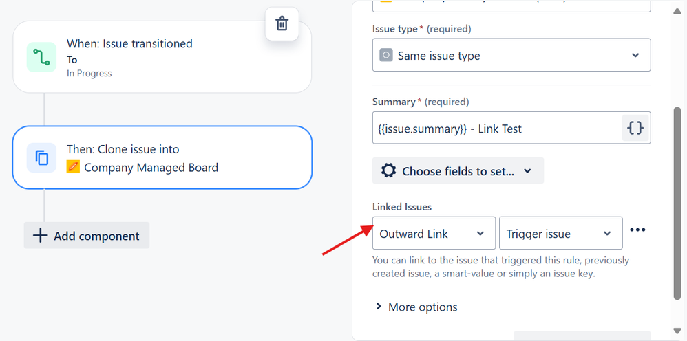

1. You will have to create unique link, cloned link type is common and can be used by many issues. Suggestion is to create a unique link; you can do that by modify your automation Rule where this cloning is happening.
2. Once you have created that unique link type you can update your existing automation Rule where you have selected Type as all linked types to that specific link type.
If you don't want to add the new link type and want to continue with clone, you use any field as a condition to separate it form other cloned tickets
