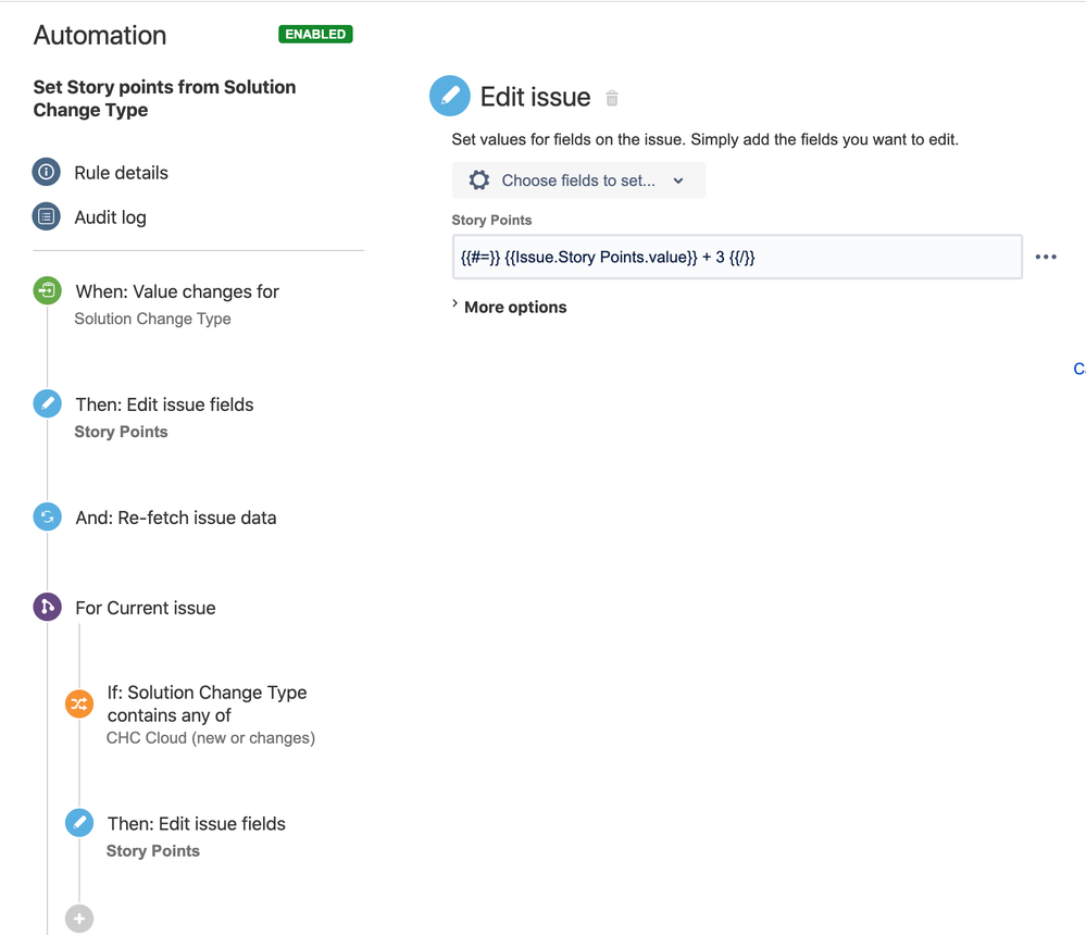

Okay, perhaps something like this:
  • trigger: some trigger you want, such as the Solution Change Type changing
  • action: edit Story Points to clear the field (or set to 0)
  • action: re-fetch
  • if/else condition...
    • condition: Solution Change Type field contains Software
    • action: edit Story Points relevant for Software to add your value
    • action: re-fetch
    • condition: Solution Change Type field contains Network
    • action: edit Story Points relevant for Network to add your value
    • action: re-fetch
  • ... and so forth

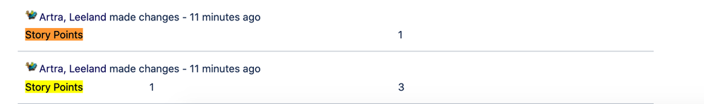

Thanks, that almost works. I built this:
But, Story Points is being set to 3 instead of the expected 4.
