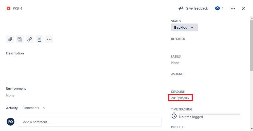

I'd like to know how I can set a date field as null, after deleting a pre existent date.
Illustrating what I want to know, I need to transform the 'DEADLINE' field from '2019/05/06' to null.

Hello there.
I'm a bit puzzled with your doubt since if you simple delete the field value in Jira it will be set to NULL in the database.
Can't you delete it, maybe? If the field isn't present in the edit issue screen (maybe it's been automatically set using a postfunction within some transition) then you won't be able to delete it directly from there. In that case you'll have to add it to the edit issue screen first.
Also, if this is just a one time thing and you don't need that field to be editable you could aswell delete the value directly from the database... might be quicker.
If you are not an admin, just contact your admin so he can do it for you.

Hi Iago,
Thank you for the attention, but what I want to do is not define a deadline to this issue.
There are some cases that deadline is not fullfilled and I don't want to predict another one. But in Jira, once I define a date to this field, I can not delete this 'DEADLINE' (date field) to empty or null.
Answering you question, I have admin access.
Regards.

As I've told you, you can't delete it because you don't have that field present in the EDIT ISSUE SCREEN. You likely have it just in the CREATE issue screen so once created you can't delete it from Jira.
You can see in my capture that I can edit the field so I can delete it aswell. I have it in spanish but believe me that's the field (you can probably understand spanish though).
Check your screen schema for the project you are interested in. Check the edit issue screen and then check if the DUEDATE field is there. I bet it isn't.
Hope it helps :)
