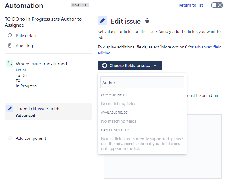

Hi everyone,
I'm trying to automate reassigning an issue in Jira as it moves through a couple levels of code review. When the issue moves from "To Do" to "In Progress", I'd like to automatically record the Assignee in a custom Author field.*
I've added Author, a custom person field, to the issue's template, but it's not appearing in the "Automation / Edit issue / Choose fields to set" dropdown. So I've been trying the advanced fields approach based on https://support.atlassian.com/cloud-automation/docs/advanced-field-editing-using-json/
Currently I get the error "COM-48 (data was not an array (customfield_10051))" using this:
{"fields": {"Author": {"id": "{{assignee.accountId}}"}}}
or this:
{"fields": {"author": {{ assignee.accountId.asJsonObject("id")}}}}
The error occurs regardless of whether or not I restrict Author to a single person.
What should I be doing differently?

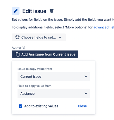

hi @jtcours welcome on the community. I just tested your use case and I can add field to Edit Issue action. It also works nicely when adding Assignee value to Author(s) field. So I think the best approach is to find out why your field cannot be used for configuration.
I have two questions
  1. Is your project of team-managed or company-managed type?
  2. If your project is of company-managed type, does your custom field have a correct context configuration?
My Edit Issue action configuration:

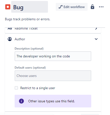

Hi @Martin Bayer _MoroSystems_ s_r_o__ , it's currently set as a team-managed project, but we're just learning Jira here, so it's possible something's misconfigured.
jtcours
February 15, 2022
If it helps any, here are the field's settings:
but the field does not appear in the dropdown for editing an issue:
