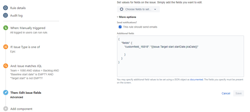

My Rule:
However, I get an Error editing issues
DTO-11807 (Error parsing date string: (customfield_16818))

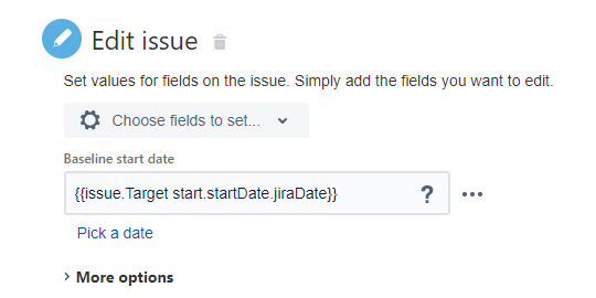

I also tried just using the following in place of the "More Options".
The Audit Log shows it was successful, but the field did not update.
I think my error is in the JSON, but could be wrong. I have tried the following in "More Options":
"customfield_16818": "{{issue.Target start.startDate.jiraDate}}"
"Baseline start date": "{{issue.Target start.startDate.jiraDate}}"
"Baseline start date": "{{issue.customfield_10103.startDate.jiraDate}}"

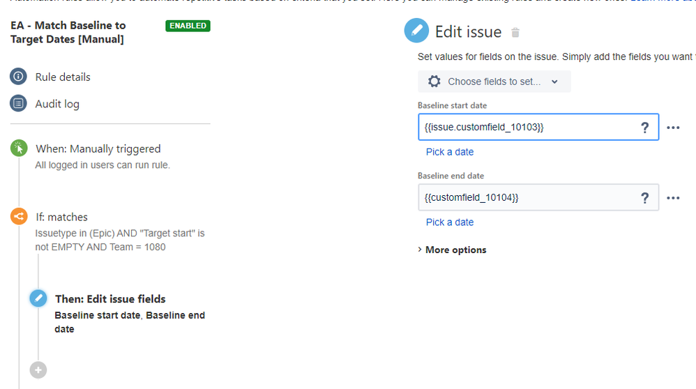

Isabella Musial
January 2, 2024
GOT IT!!!
I was definitely overthinking it! This worked.

Hello,
I don't have those fields in my instance or even comparable ones to test but the JSON may possible be off. Myspacing below maybe off but even the target fields have custom field values so possibly try that
"fields": { "customfield_XXXXX": "{{issue.customfield_YYYYY.jiraDate}}"
Isabella Musial
January 2, 2024
I tried that one, too.... that didn't do it. My Baseline start date still did not update sadly. Audit Log says no actions performed.
"fields": { "customfield_16818": "{{issue.customfield_10103.jiraDate}}"

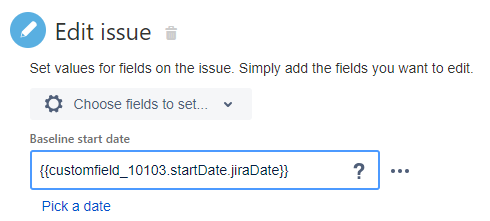

This may not be related to this response, but I also tried using the dropdown and selecting Baseline start date (customfield_16818) and entering the Target start (customfield_10103).
My Audit Log shows success - but the Baseline start date was not updated.
Isabella Musial
January 2, 2024
Also tried the following in the Baseline start date field (above) to no avail!
{{Target.startDate.jiraDate}}
{{Target start.startDate.jiraDate}}
Audit Log keeps telling me that my issue was edited successfully...
