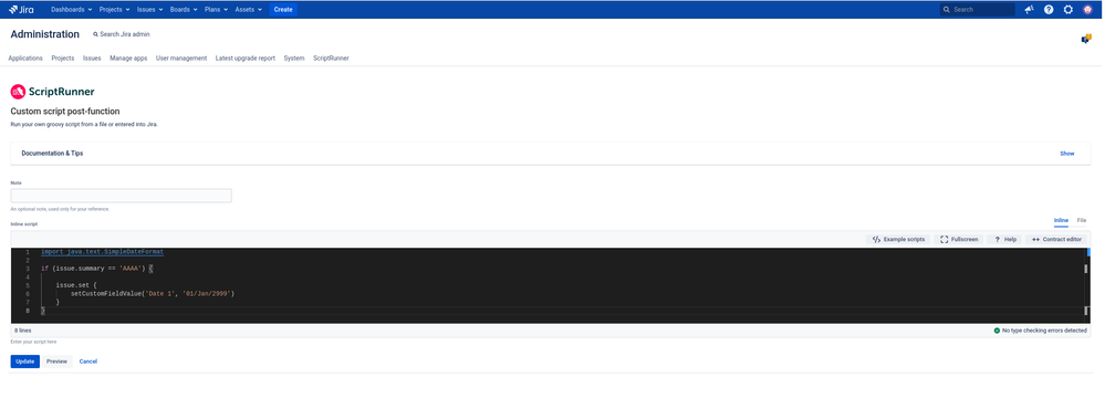

For your requirement, I suggest you look into ScriptRunner's HAPI feature.
Below is a sample working code for your reference:-
if (issue.summary == 'AAAA') {
issue.set {
setCustomFieldValue('Date 1', '01/Jan/2999')
Please note that the sample working code above is not 100% exact to your environment. Hence, you will need to make the required modifications.
Below is a screenshot of the Post-Function configuration:-

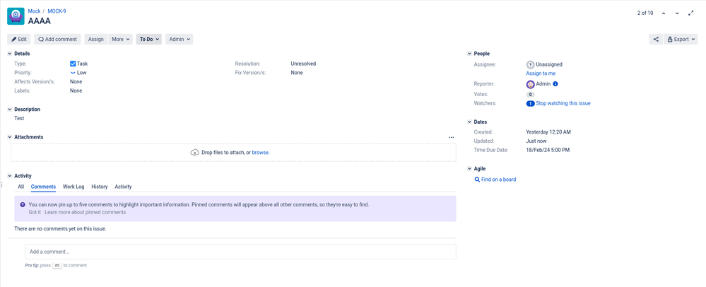

I am also including a couple of test screenshots for your reference:-
1. When the issue is first created no value is added to the date field, i.e. Date 1 as shown in the screenshot below:-

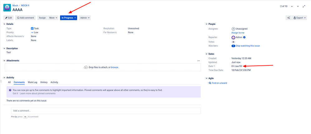

2. Once the issue transitions to In Progress, the Date 1 field is updated to the value 1/Jan/99, i.e. 1st January 2099 as shown in the screenshot below:-
I hope this helps to solve your question. :-)
