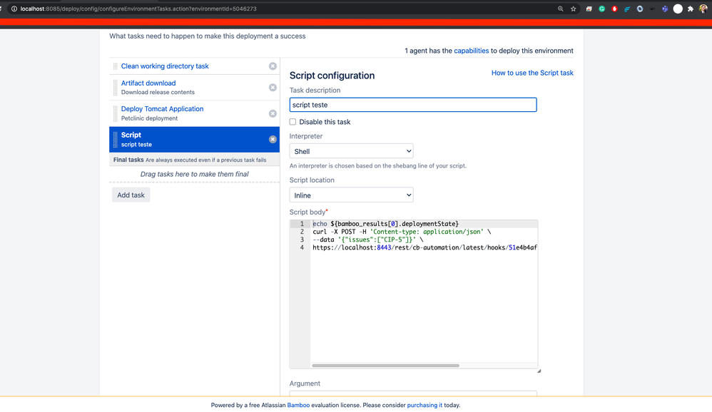

I thought about using the Script task to send the webhook with this information to Jira, but I'm trying to print the variable on the screen as shown in the print below and it is not displayed on the screen but no error message appears.

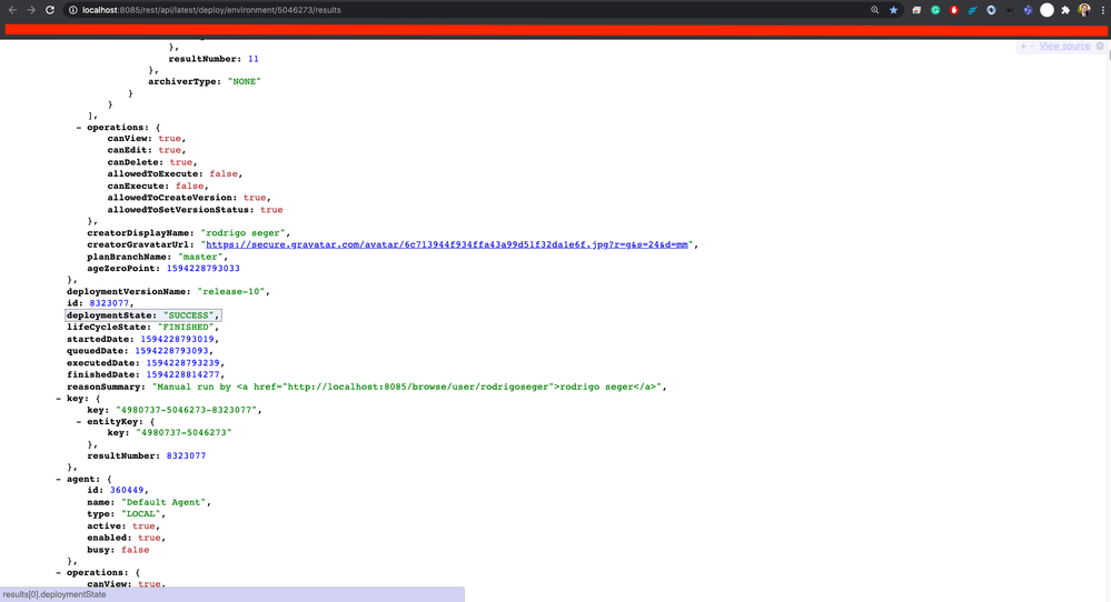

The field that I'm trying to send to Jira via Webhook.
The script I made on Bamboo to send the webhook to Jira.

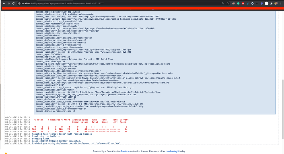

Log of the last deploy I carried out testing the value of the variable "deploymentState" on the screen.

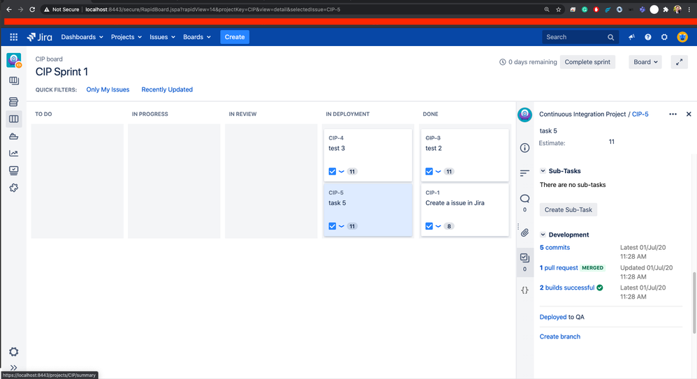

Project board in Jira, where I want to transition the issue from the Build column to Done column.

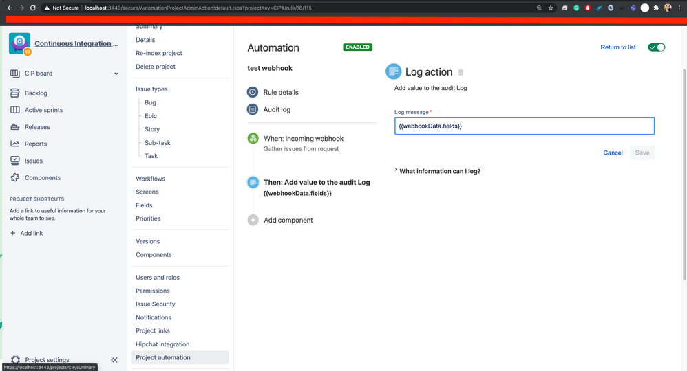

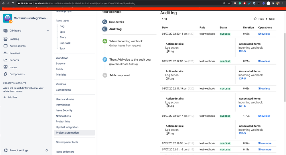

Log of the Automation Rule to check if Bamboo information is arriving correctly in Jira.
Result of the last tests using the automation rule with Webhook.

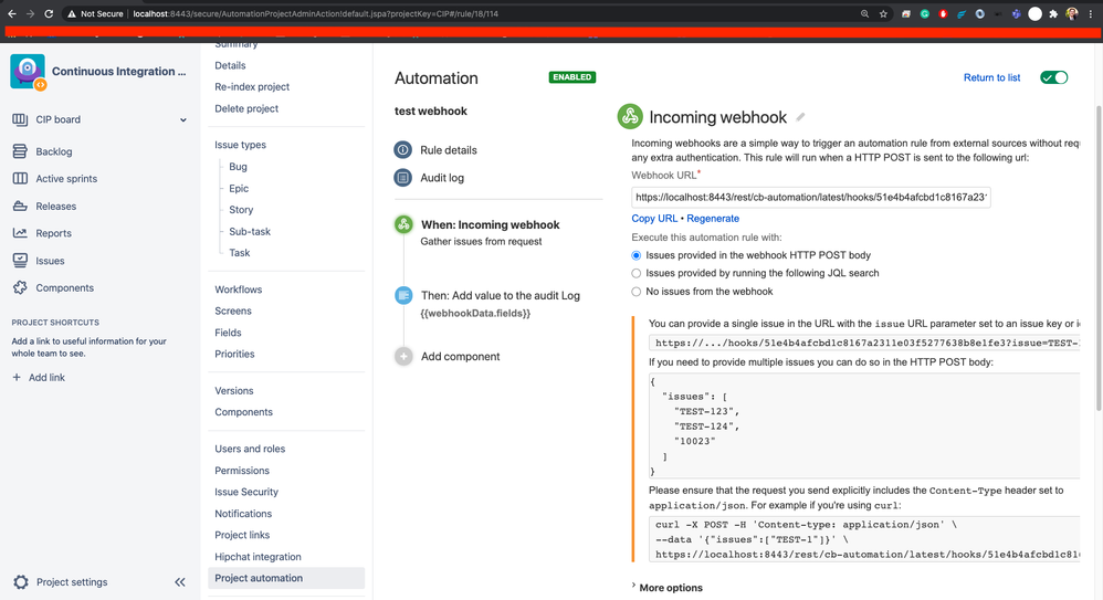

Automation rule being triggered using Webhook.

In the automation audit log screenshot, it appears to be successfully picking up the correct issue: CIP-5. That's a good start for the automation rule. It seems like the next problem to be solved is to pass along the success / failed status information as a part of the webhook data.
To do that you'll need to:
- Move the script to the final section (so that it runs on success or failure)
- Pass the ${bamboo.buildNumber} to the script
- Lookup the build result (see REST api here: https://docs.atlassian.com/atlassian-bamboo/REST/7.0.4/#d2e3009)
curl -X GET --user admin:admin "http://localhost:8085/bamboo/rest/api/latest/result/{project}-{buildkey}-{buildNumber}?buildstate"
- Parse the json and get the final build state.
- Pass that along to Automation via webhook.
