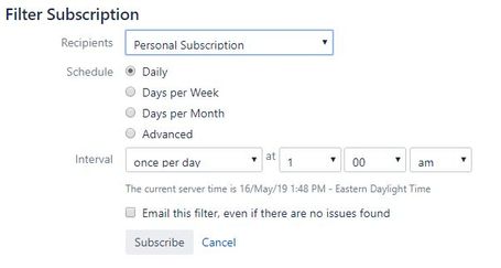

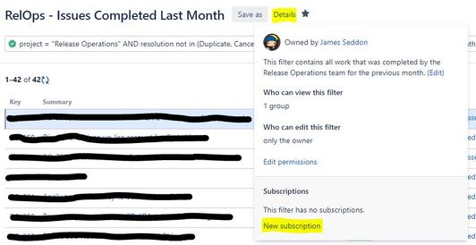

The first thing that came to mind for me was for you to create a new Jira filter (query) that will display a list of issues that you need to send reminders out for.  Once you have a the list you can save the filter and then in the details link next to the name of the new filter you can setup a subscription.
From here you can define the group you would like to send that list to as well as how often you would like to send it to them:

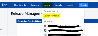

You are going to start by select the Issues menu and selecting the "Search for issues" option

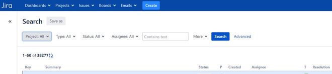

Next you will probably be taken to the basic search editor that looks like this:
I personally click on the "Advanced" link to use the advanced search as there is more you can do with it:

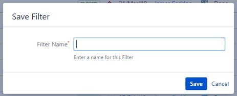

Once you search for some issues and click the "Save as" button.  It will prompt you to provide a name:
Once you have saved the filter you should see the details link near the top middle of the page link in my first screen shot.
