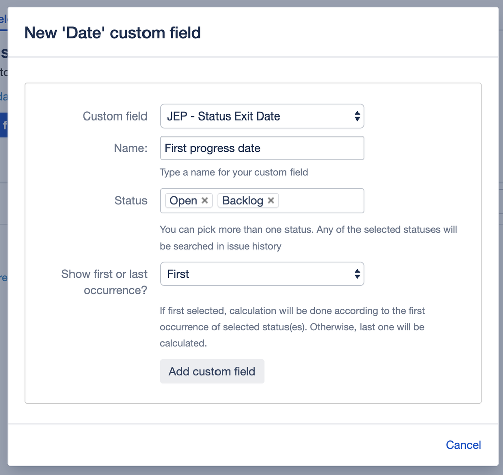

Enhancer Plugin for Jira has a custom field called "Status Exit Date" that records the last time an issue is transitioned from a status.
Status Entry Date also works in your use case. Just don't forget to select all the statuses that the workflow has in the configuration screen and select last occurrence in the configuration in both JEP custom fields.
You can define different JEP custom fields for each of the workflows or just use one Status Entry or Exit cf but in that case, you should select all statuses (active) in your Jira instance
After adding this field to necessary screens, you can add this field as a column in the search screen and use ORDER BY feature of the JQL to see the last time an issue is transitioned.
If you're interested in a specific WF, just include the projects that use that WF in your JQL query.
This search should give you an idea that which workflows are actively used in the recent days/months/years. Based on the results, you can manage the not-actively-used workflows.
