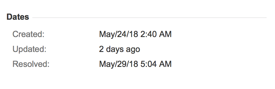

Hi @Prakhar Srivastav {Appfire}, I'm not talking about the Resolution field. I'm talking about the Resolved field, which shows the date the issue was resolved. As far as I can tell, Resolved should correspond to the internal resolutiondate field, which is not being set for issues in my project.
Here's a screenshot of the field I'm talking about. This is from a project that does have the Resolved field:
I would like to be able to use this field in my other projects.
June 14, 2018
I meant to say that Resolved is a calculated field so you can not add these fields to screen.
Samuel Groves
June 14, 2018
I understand now. Thanks Prakhar.
