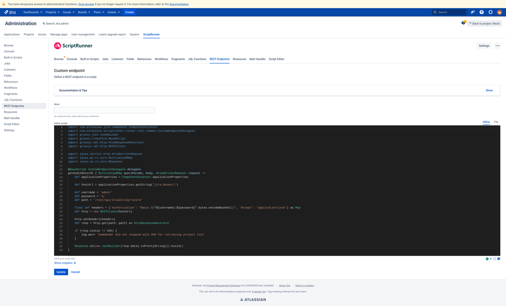

Below is a screenshot of the REST Endpoint configuration:-

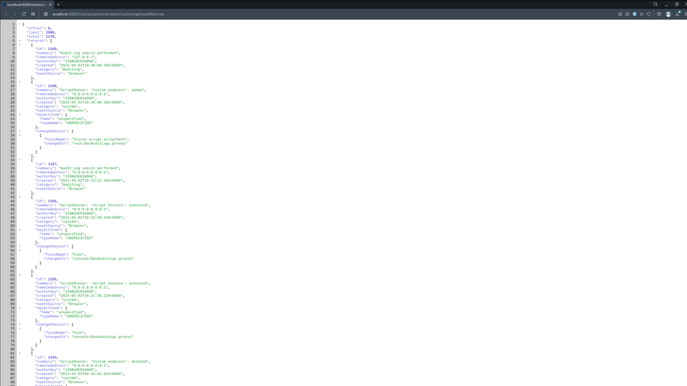

Below is the expected output:-
